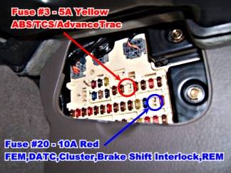

Just last Tuesday I got the uploads working consistantly - there was an issue with the ABS/TC and FEM, REM modules sharing the same data bus as the PCM - so when you tried to upload the other modules got in the way.
I pulled the fuses for these modules and the upload works fine.

if you purchase a SCT Flasher you need to pull two fuses from the passenger footwell fusebox when uploading.
