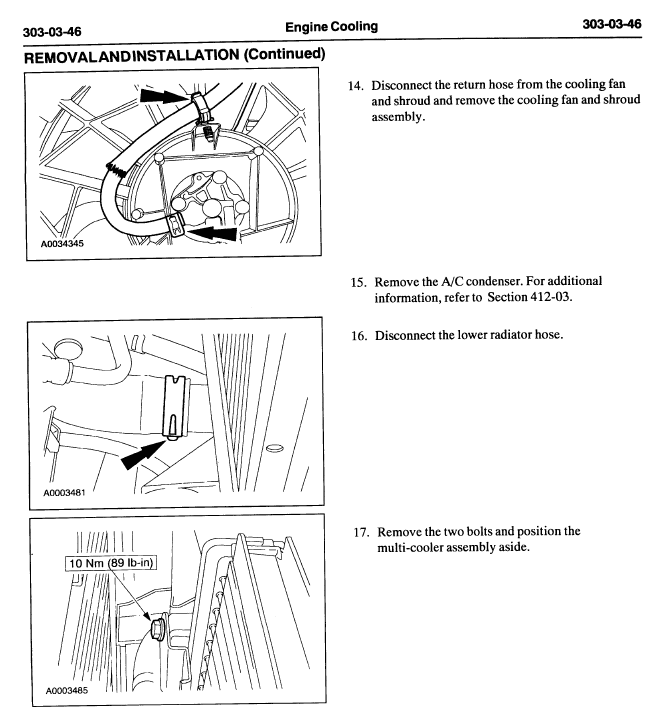

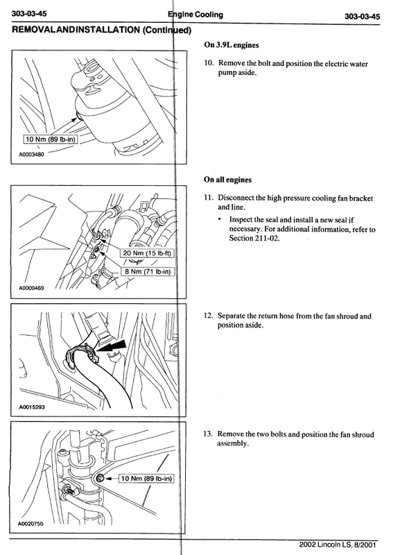

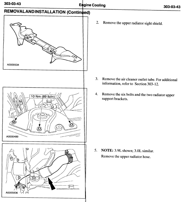

Good point. Hadn't thought about that site being gen II specific. I have a gen 1 manual here in PDF form. Let me grab some screen caps:

Sorry if its a dumb question but I followed directions to a T but for the life of me I can't figure out how to disconnect the high pressure line going to the fan... My wrench won't fit an when I finally got the wrench on, I started stripping it even when using the correct size.
