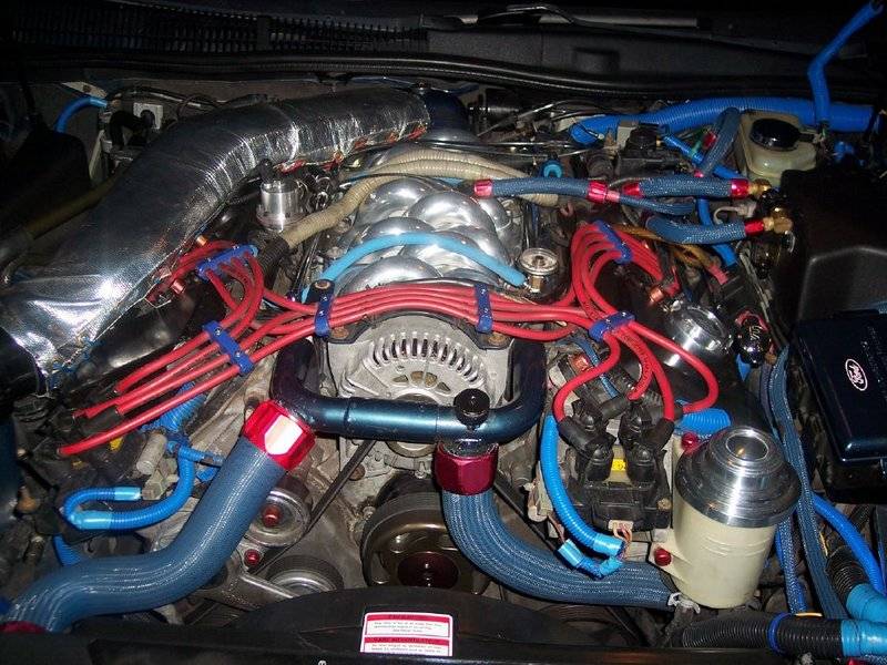

The FC332-4 AQP hose is a -4AN size which is 1/4" ID and is rated for 250 psi .
Hmmm, don't think I have any -4 laying around. My feed is -10/-8, and my return is -6. Ah well. :(

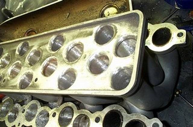

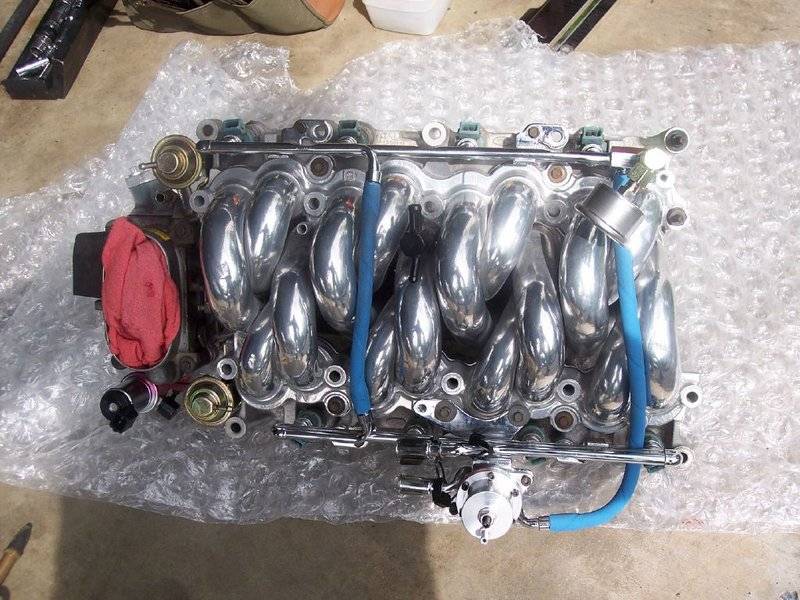

Doin it again...what did you do with the IMRC plates? Deleted, polished smoothed?? You said the intake was polished and coated, what was it coated with and are you just talking about the exterior of it?
The intake was complete when I got it. The IMRCs that were attached were filthy. I hot-tanked them and cleaned them up and light polished them leaving the butterflies in and functional. I replaced the IMRC vacuum actuators with new ones.
I'm not sure of the exact coating the intake had done to it. Ceramic? All I know it is as smooth and polished on the inside as it is the outside. :D
