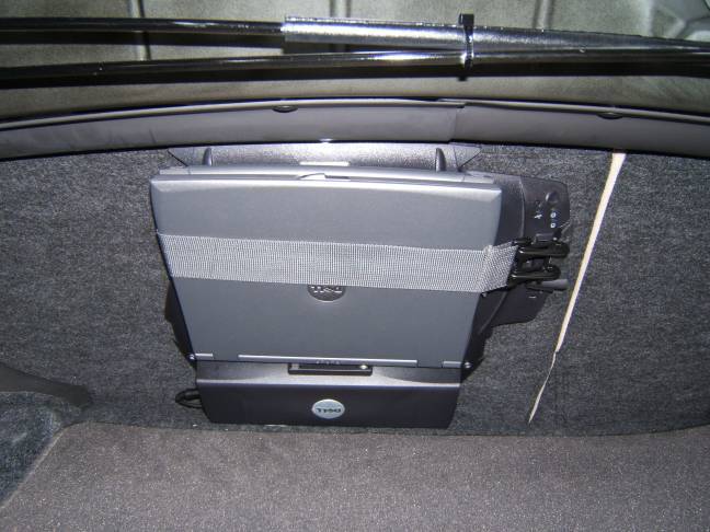

Here is a pic.
It's docked into a docking station - which is bolted to the backside of the rear seat. This is all hidden by the rear sub-box.
wut xactly do u use the computer 4? i dont quite c the purpose...unless its 4 show then i understand completely. am i missin sumthin?
data logging. this way he can make adjustments to his Xcal2
a couple of things.....
the laptop is connected to a PIE adapter - so I play WMAs/MP#s through it into the stereo.
I have:
- the AutoEnginuity's ScanTool connected to it for real time display of the various engine sensor and datalogging. It can perform many, many tests and readings.
- PASS software to download my G-Tech Pro Competition to. It displays 1/4 miles times, HP, Toruqe graphs.....
- software for my Innovate's LogWorks datalogging for the wideband O2 sensor installed
- SCT's LiveLink to bridge the XCal2 and the wideband into a single datalog file
It connects to my home network (so I can pulll down new playlist off the media server)
I also have a Cellular Modem in it - so it has internet / e-mail access. I have a blue tooth wireless mouse/pointer for it and on-screen keyboard.
I am also thinking about adding MS STreets & Trips with GPS......
