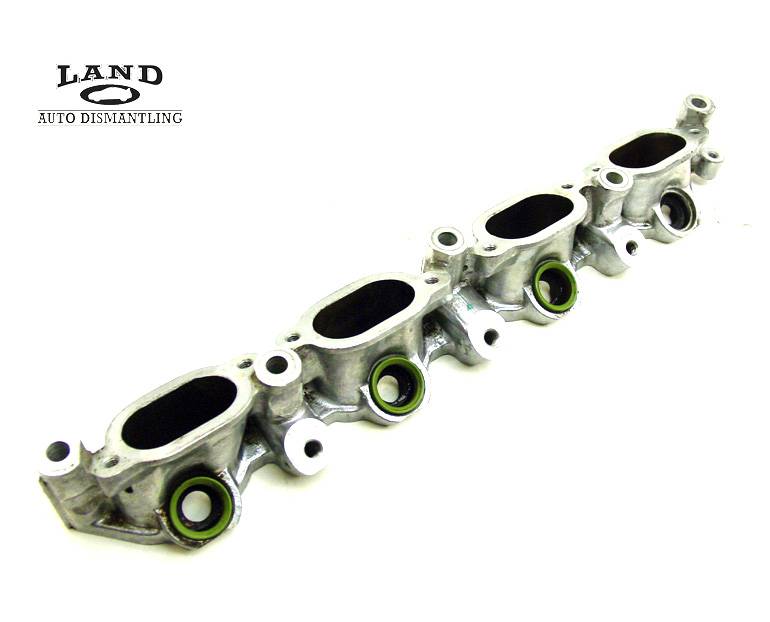

Attached is what the Jag adapters look like
Do you NEED the box intakes your making to bolt to those? or can they just be welded on? I would just make 1 inch tall ovals and weld them to the box then weld them to that jag flange. As fo making the ovals just take the 1 inch or what ever height you need and cut them in half and weld in 2 str8 pieces to make ovals. Making those out of billet waste to much stock.

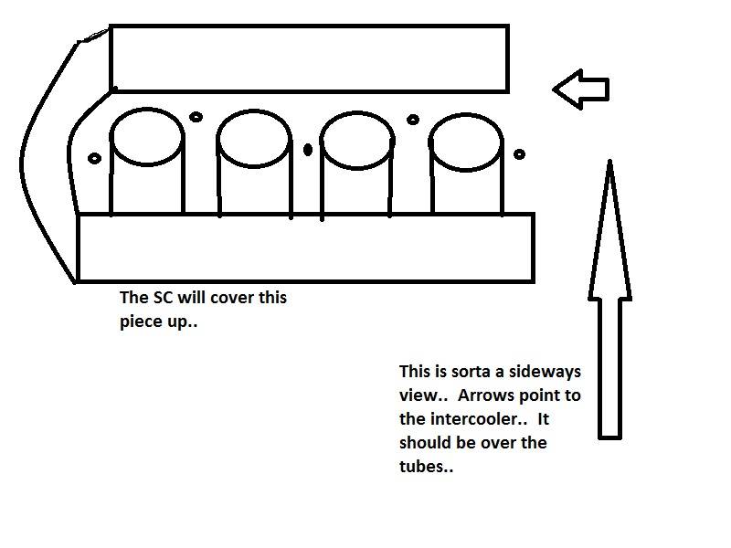

I have the machine shop making a 1/4 inch bracket to bolt onto that out of aluminum stock.. Maybe I'll draw my design tomorrow because I'm too tired at the moment..
If box needs to bolt to that jag part. I would machine down those 5 bosses that bolt that to the head. Hence making it flat. Then just take 3/8 thick bar stock to cover all ports drill in the bolt pattern so it bolts to that. Cut in the ovals then weld ovals to the 3/8 new flange.

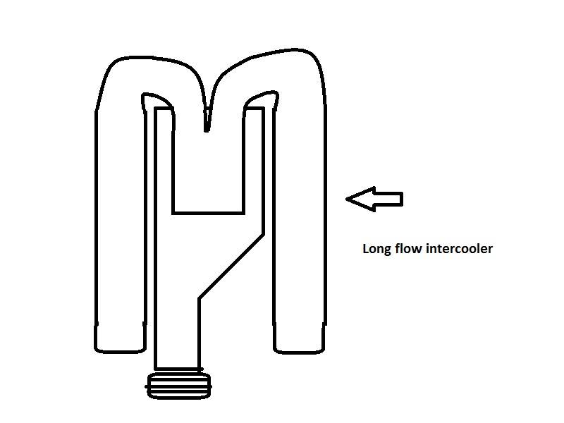

No.. My plan was to use 2.5 silicone piping off the SC, make a 180 and go through the Intercooler, make another 180 and go into the square aluminum which gets fed to the ports..
Silicone piping? I'm more confused now. I might have to wait un till you draw stuff out.
