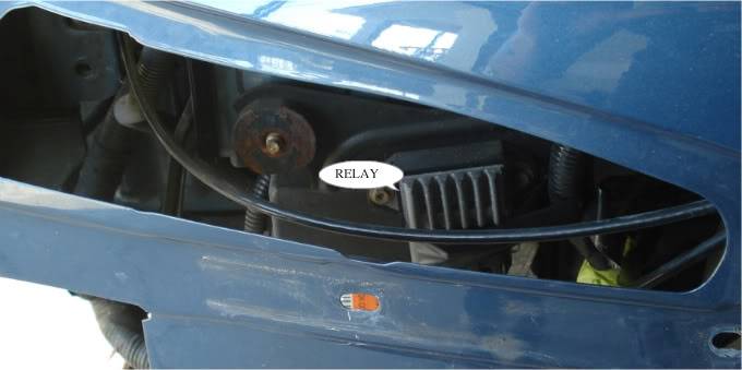

Thanks again Unity. Can anyone direct me to the location of the relay that I should be inspecting?

I don't know if the relay is dead! Where is the d*mn thing so I can check/replace it? Is it in the relay box under the hood? If so, which one is it?:confused:
ok ill give away the secret! swap the air ride relay with the abs relay. air ride relay is on the front of the compressor bracket pass side ft bumper cover and the abs is on the driver side similar location.
And the ABS is easier to get to if you remove the driver's side side marker. It has one retainer nut on the inside and one screw on the outside. I use a ratchet with torx fitting and remove it that way. Just dont drop the harness. At least its quicker for me than removing the liner, etc.
Oh... ya... Not sure? I would bet it would be easier on a Gen II. But I never removed a headlamp assembly on a Gen II. But I would think the relay would be in the same spot. I dunno. I just know my relay went bad. It literally corroded on the inside and ruptured out. The compressor would barley run after about 20 seconds. Swapped em and all is good. Just not sure if I can trust the ABS now! :)

Thanks '93 Blue on Blue. I'm still trying to figure out how to get the compressor out. I removed the headlight (cake like the previous post said) but I can't see how to get the compressor out. I see a bolt on the right side that looks like it goes to the compressor bracket. I can see the finned aluminum relay that is in question. But I can't get to it. There is a liner on the bottom directly below it. I'm assuming that if I remove that liner I can get to the compressor...we'll see.

I just removed my relay with everything in place. Ratchet with torx attachment. Little but of work but probably easier than taking the whole thing out.
It was the relay. I switched the ABS relay with the comp. relay and VOILA no more "Check Air Ride" message. Now I need to head over to the man-mall (junkyard) and grab another relay for the ABS. And replace my rear bags!
