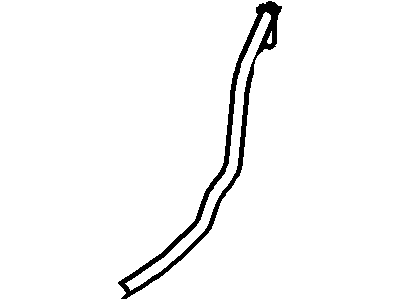

Had my fuel tank pressure sensor replaced but one of the fuel lines cracked on the ends and I can't find a replacement anywhere. The mechanic repaired the line the best he could and there is no leak anymore but I would like to replace the section of that hose the correct way if it is at all possible I am looking for part number XW4Z-9327-AB Any help would greatly be appreciated!
Does it look like this?
Nope it looks like this XW4Z-9327-AB - Genuine Ford Base No. #9327 Hose - Connecting
I just can't locate one anywhere!

Was trying to avoid getting something that old used cause most likely a good chance I would be in a similar situation but I guess I could get lucky. And it's for the V8 as well I had my car details in on the parts site and it said it was the correct one.
Have you cross-checked with the 1st Gen S-Type yet? Should be the exact same part from 1999 up to the 2003 MY change. I'll see if I can find a pic & part #. I'm pretty sure it's the same part regardless whether it's V6 or V8, at least according to the parts catalogs.

@HRLNKN Just thought I would give you all a update! I got the new part in today and guess what.... It came in a Jaguar/Land Rover Box had a Jaguar part number but the line had a Ford sticker with the Ford part number on it. And it's the same exact part number!
