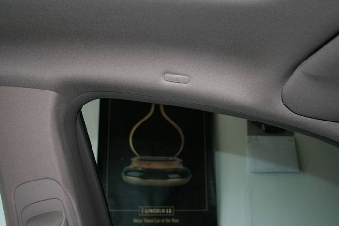

Maybe its the side curtain airbags. There is a badge on the roof if you have them.
myfirstlincoln;2037343185...I know I have 8 way said:
Like he said, you'll have an SRS badge on the headliner if you have side curtain airbags.
The difference is that you have a different kind of airbag in the seat depending on if you have the side curtains or not. It's important to get the right kind. Otherwise, you'll have too much airbag or too little.
Thank you for the response! I do not have that badge and wasn't even aware that was an option. I'll look for a seat without the roof airbag.
