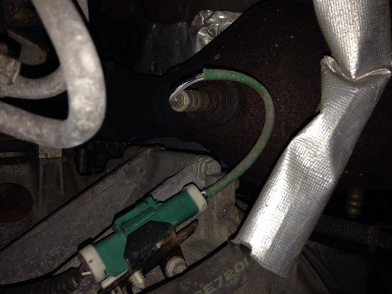

Anyway, I have since cleared the code - whose description is "Oxygen Sensor Circuit Slow Response Bank 2 Sensor 1" - and I want to make sure I'm looking at the right O2 Sensor. Is Bank 2 the driver's side and sensor 1 the upstream, green-wired sensor? I know this has been gone over before but I have gotten mixed answers from other threads I searched.
This might not be a big deal, but I figured I would fix it now since the price doesn't seem too bad. RockAuto has a Motorcraft DY1039 for $35 and the picture lines up with what I'm seeing before the cat converter. Is this the right part number and location? I'll post a pic of the driver's side sensor I believe it to be.

Yes, forward most on the driver's side.

If the same MIL returns and remains present THEN you'd have something to worry about. At best for now, you could attempt to disconnect and reconnect that Upstream sensor, see if you can spot any contact corrosion inside the connector. Click it back in good.
