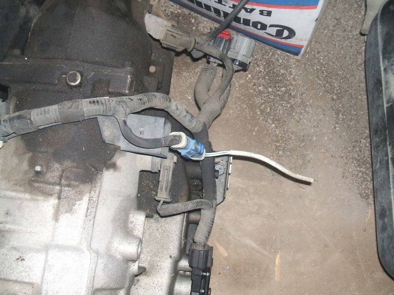

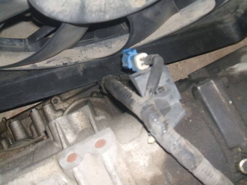

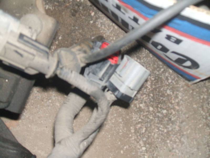

Well, dropped the engine and trans today, will get to see soon, what's messed up in the motor. :shifty: Glad the damn rain, wind, and cold finally stopped for a day! :D Anyhow, on the 97 I got from Nolan (good guy, still owe a debt of 25 to him) it has 3 more connectors then my 94. Do I just have to swap the main harnesses? Here are the pics. Oh, the two blues and the black are the ones I am referring to.

The blue connectors are for the extra cats that the 97 has.:)
There are two additional O2 sensors on the 97 (total of 4) since it's OBD-II (rear two are after the cats to monitor their performance).
A 94 only has two O2 sensors. I don't know what harness you have and maybe two of them are for these.
OOps, like he said, I meant extra O2 sensors, not cats.:)

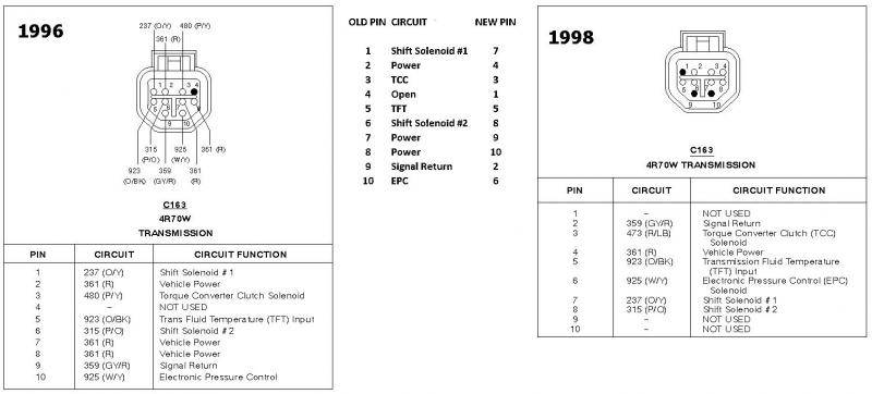

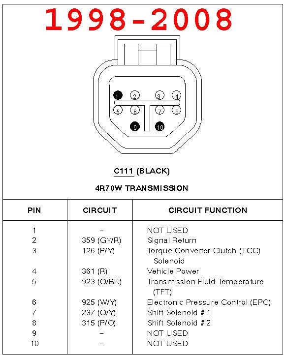

As far as re pinning for a 98 trans, I'll never understand why you would want to go through all that instead of repinning the connector. It literally takes 2 minutes to re pin it. Just make sure you are using the right drawing. There was a wrong drawing going around at one time.
As far as the other connector, I'm not sure, but who cares, just use the right harness.:D
Some people say you don't have to swap the TCC solenoid. I'm not sure, I always did, it's easy, I had the part anyway, and I've never had a problem.
I posted a correct re-pin diagram in this thread.
