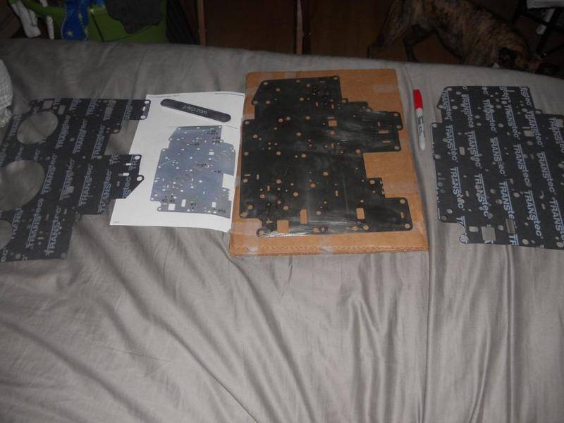

These are the parts set up, gaskets and J mod write up and the drilled separator plate bought from http://www.robstireandauto.com/products.html I only paid $45 shipped because all I needed was the predrilled plate

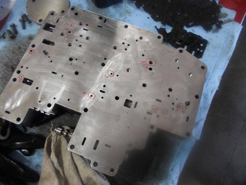

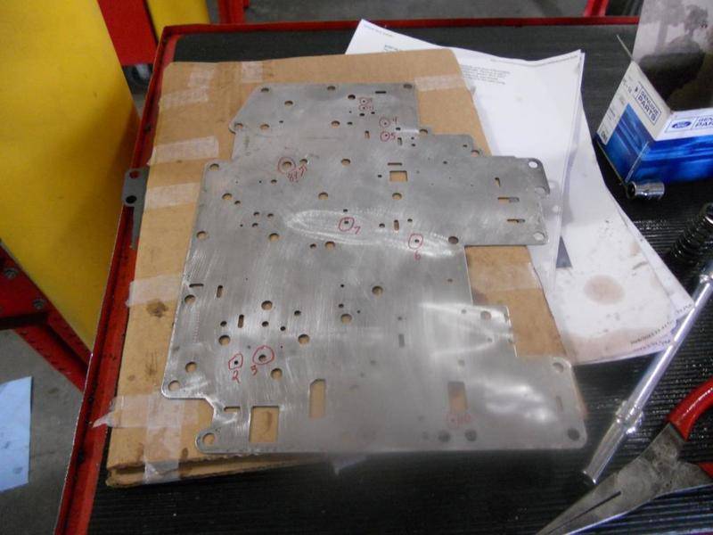

I have to send back my original undrilled plate. I circled all the holes that needed drilled and made sure they were all drilled out correctly.
Plate with numbers circled to make sure all holes were correctly drilled, I ordered a 1995 300 hp spec sep plate.

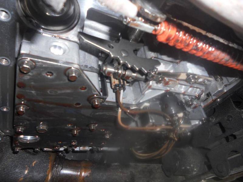

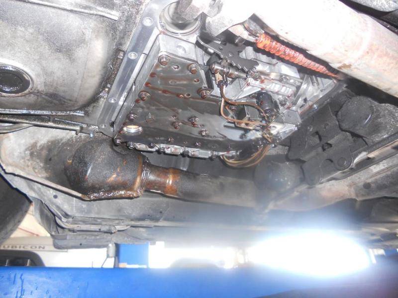

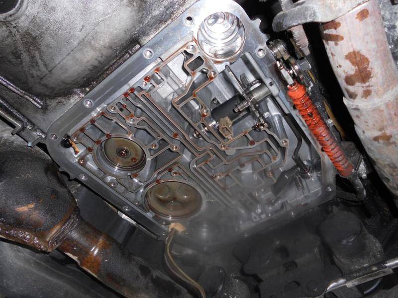

Make sure that bracket, the rooster comb and shifter valve are memorized in the proper place so you can put the valve body back without any problems

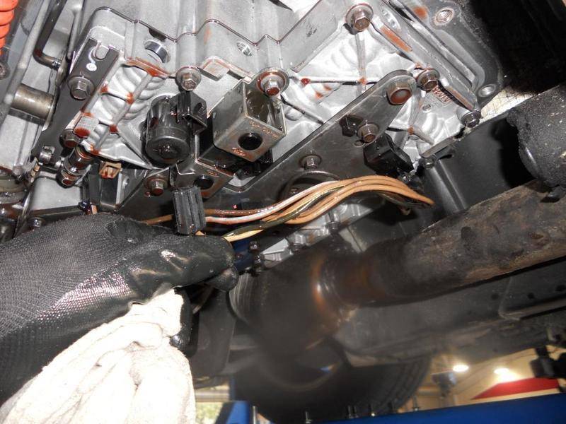

This picture shows the four electrical connectors in their proper place but this is really fool proof because the wire harness is perfectly matched so you can't really plug in the wrong connectors. Better safe than sorry, I always say.
Another shot of the rooster comb and connectors and shifter valve thing

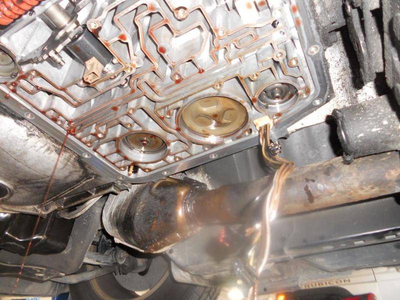

Valve body removed, notice the 1-2 accumulator piston cover is still intact and so is the 2-3 accumulator piston cover. It is way easier to remove the snap ring holding the 1-2 piston assembly in with the valve body removed.
Here is the part that had me stuck for awhile as I tried to figure out why the heck it was so much harder to get the 1-2 piston assy' back into the bore. As you can see, the bore is tapered, so my piston kept getting stuck on the lip up top. In order to install the piston, it has to be installed straight up into the tapered area of the bore or you'll never get the piston assy' installed. I used a 6 inch long 1/2 inch extension with a 22mm socket under the piston and put it into the bore as straight as possible and it went all the way up into its bore. My piston was in good shape and both springs were not broken. The upper spring was orange and the bottom was purple. I replaced both springs with 2 purple ones. Once the piston is in its bore, its easy to install the lower spring and cover. Gently use the C clamp to keep it in its bore while you reinstall the snap ring.

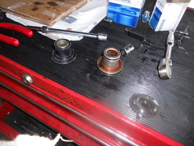

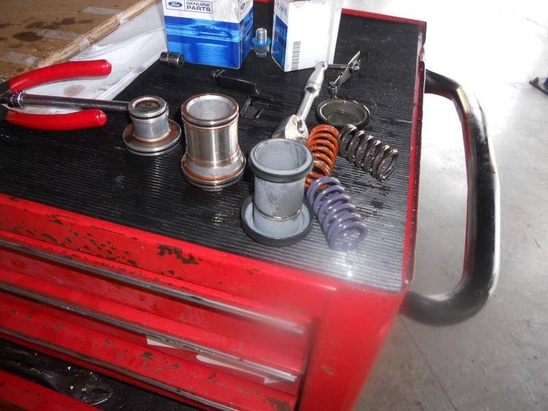

This is the original 1-2 piston and the original springs with a new spring, the other purple spring was on another bench. Notice the old style 2-3 piston in the back ground. Also notice the two 8mm bolts with the bracket and rooster comb wheel in the back ground.
This is the new style 2-3 piston next to the original. Notice the 2-3 piston cover in the picture. I did not have to bend any tabs to keep the 2-3 piston in place, the cover had plenty of tightness. I left the lower spring out as suggested by everybody. Don't forget to lube up the new pistons with fresh Mercon V.
This is the sep plate with holes circled just to make sure it matches up with the TCCOA article pictures. All holes checked out. Number 10 is the larger reverse engagement and it now goes into reverse right away, no lag.

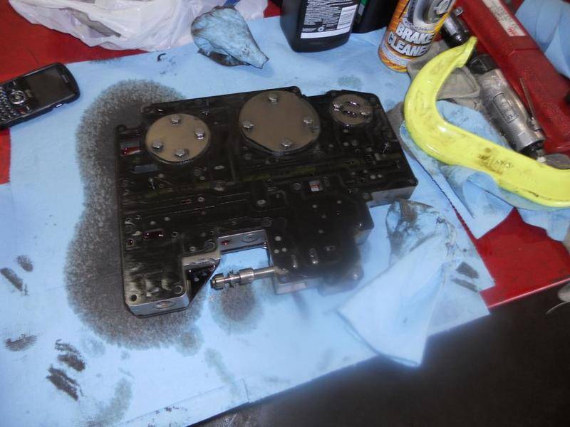

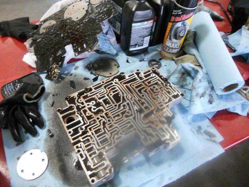

Valve body assembly removed and ready for surgery. Memorize the Pac man shaped discs but I think they only go a certain way. I just laid them out like I took them off to be 100 percent.
Separator plate and Pac Man reinforcement discs removed. This was a pretty gay part of the job, gasket removal. You will need a good razor blade or razor scraper to make life easy. I only had a few areas that were hard to remove but from the valve body. Since I have a new predrilled sep plate, I didn't have to remove the old gasket from the sep plate. I guess Rob will have to do that when I send in my sep plate. Make sure none of the old gasket has fallen into the little mazes in the valve body. If they do, make sure you pick it out.
This is the new sep plate ready to get bolted onto the valve body. Make sure you use fresh Mercon V to wet the gaskets as you put it onto the separator plates. Next you just have to reinstall the Pac Man discs and torque everything to 92 inch pounds.
DON'T FORGET the single 10mm bolt that helps secure the sep plate to the valve body. I kept the valve body up the whole time to prevent screens and check balls from falling out. The fluid inside was pretty fresh so I didn't really have to clean the valve body.
