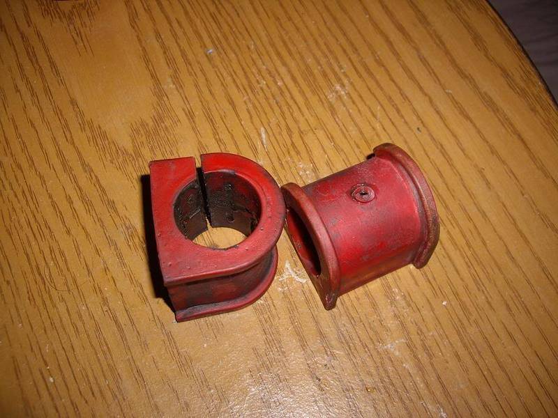

Quick question. I need sway bar bushings for 95 LSC, when I look on Rockauto it list 3 different size bars. Does the LSC come with 3 choices or are they just listing the base ones also. Also, what bushings are most of you using???

I have a newish set of Poly ones ill sell ya cheap. :)
FYI, I went and bought a vernier caliper to measure the bar and I had the 1.06 bar. Put the bushings in=no more noise. Car had a rattling/clunking noise over bumps pretty loud. The bar was swimming in the bushings causing the noise.
