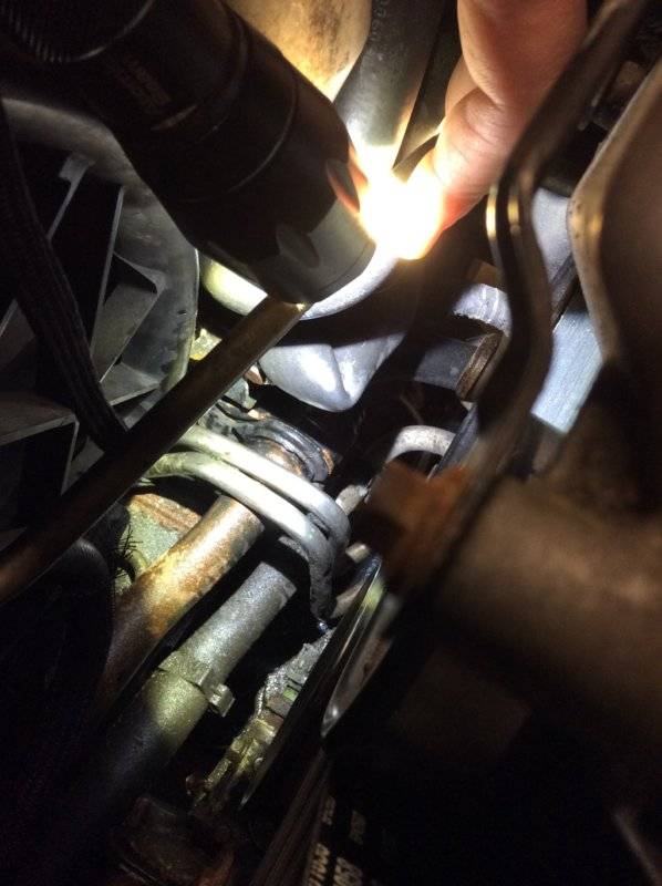

Hey Guy’s as always I hope this post finds you feeling well ...Anyway on my one day off during the week I decided to have a go at replacing the plastic coolant parts on my Gen 1 V8 one thing on my long list to do with this new project car ....I was going through the process disconnecting the tensioning rings on coolant hoses when I looked down under the auxiliary coolant pump and saw two hoses coming off some other part I’m not all that familiar with and low and behold they are kinked or bent in a manner that doesn’t look good....I tried taking a pic of the hoses but the picture is less than average ...apologies for such a lousy pictur but it’s not easy with such a small space not to mention the auxiliary coolant pump is hanging in the way so someone must have replaced something at one time or another but put the hoses on all $*#&# up if you know what I mean...a little more info is the two hoes do turn into metal piping towards the back of the fire wall location
Any help in identifying these two hoses would be much appreciated
1st GEN's have the Auxiliary flow pump on the top side with the DCCV at the bottom.
2nd GEN's have it reversed.
IIRC
... the two hoes do turn into metal piping towards the back of the fire wall location ...
that would be the pluming leading into the insides of the car, behind the dash, where we keep the 'heater core'
DCCV, regulates by means of the DATC the desired inside cabin temperature. Supplies hot coolant flow. Dual meaning, Passenger or Drivers side independently temp control.
Make a note that your 1st GEN DCCV has 5 connection in/outlet tubes.
where as the 2nd only has 3
XW4Z-18495-AA // Gen 1 only // has 5 connections
MOTORCRAFT Part # YG355
Do not order the 'YG378' ... it's the same base P/N but the prefix differs between the two GEN's

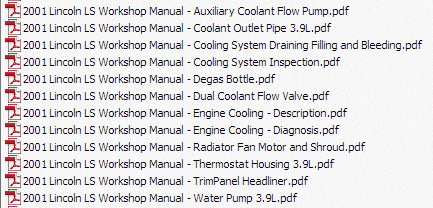

Dutch,
follow the links in my Tech article, it will break off into individual components with respect to the cooling system.
Cooling System 3.9L - 1st GEN Lincoln LS w/ PN's
Okay thanks for steering me in the proper direction with those part #’s
Well this would explain why the car doesn’t have any heat blowing in the cabin damn hoses are kinked ....whoever was playing with them didn’t have a clue
Dutch,

Dutch,

After taking the DCCV out tonight I see the whole top connection is missing ...that would explain the random connector hanging off the auxiliary pump wire harness...so I purchased a new one off Amazon which willhopefully solve my no heat problem...anywho I have a question about the auxiliary pump....If I put the key to the on position but DON'T start the car ...with the key in the on position would I be able to hear the pump turn on?
