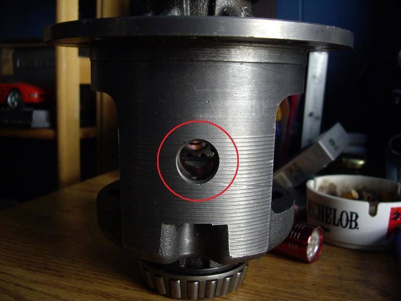

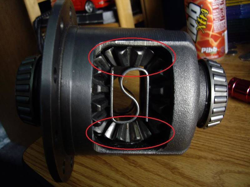

I am playing with my Trac Lok and have a question. It didnt come with the pinion shaft or the lock pins for it. Does my open carrier have them and do I just use them or do I have to buy them from somewhere?
I cant turn them at all but figured as much with 4 clutches per side and the stiffer spring.
NM, once again that service manual saved the day. It shows the pin and lock pin for the Marks open diff is the same part number as what the Mustang gets in its Trac Lok. So I guess I justuse the old one. :)
