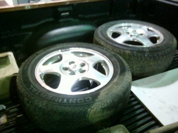

Do the center cap type deals on these wheels come out?
but the weight has to be different with a whole 1" (even if it was a 20lb difference per wheel i dont think it would matter too much with this near 2 ton beast)
Not necessarily, and rotating mass has a much greater impact on performance.
stock for stock, do you really think there will be much difference? these are not any type of "lightweight" wheel.
with all of the rotating parts including the rotor, what do you think that the difference in rotational mass will be in each corner the between the stock 17" and the 16" (also with the 1" less wheel that means you will have 1" more rubber)(yes, I know the metal weights more than the rubber)
it will be a very small percentage of change, couple that with the excess weight of the car and i say that 19 out of 20 people couldn't tell the difference, let alone make much difference on a test track(straight line, or handling through curves)
now a set of 4" wide drag lite's might be a slightly different story
