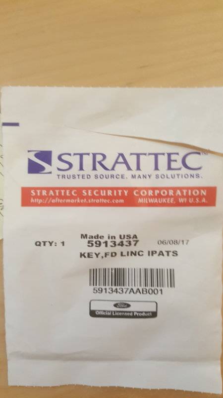

I just got one working on my 2005 V6. The link below has some good info on which blank to get. The 80 bit keys appear to be backwards compatible with the 40, if you get the right one.
For me it was Strattec 5913437. Worked fine, starts the car.
