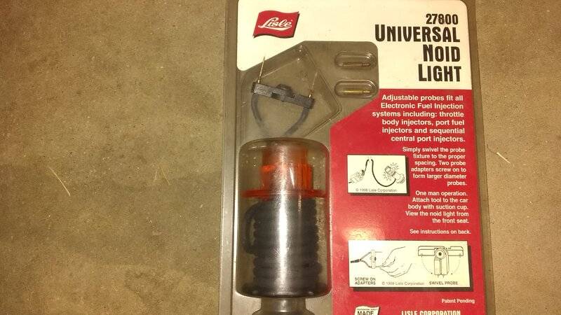

You can also check your injectors electrically
by using something like this.
