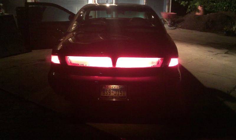

Put my glitch in last night... works great but..
Myco
Nov 28, 2008
913
8
Houston
The center light doesn't light up with the brakes. Also, I didn't find a spot to plug that ground wire that is coming out of the light to. The neon has been off my car for over a year so I don't remember where that ground went to and didn't see a where it went.
Anyone know what's going on with the brake light? The neon lights up when the lights are on but when you hit the brake it doesn't light up.
Thanks
Also, I didn't have my old ballast. I came across this thread.
http://www.lincolnvscadillac.com/showthread.php?t=73096&highlight=glitch+++brake+light
In which the OP says you need the old ballast for the swap. Only thing I can think of is needing the old plugs. I just soldered everything.
I think it grounds to the trunk.
The ground strap is short, look for a hole a sheet metal screw would fit into.
I can look later I don't remember.
I think you need the old ballast for the plugs, ground strap.
There is a adjustment on the ballast for brightness.
Try playing with it, maybe is too bright to start with.
there is a tiny screw on the side of the ballast, actually if you read all the directions you would have seen rich tells you right off the bat you usually have to dim the light down, the way it is right now, your setting on the tail light is too bright, thats why you cant see a change when you hit the brakes, you have to use a small flathead like for eyeglasses to turn the screw, keep turning it while the tail light is on until you see it dim down to match the tail lights on the car, then step on the brakes and you will see the difference, its easy to adjust.
