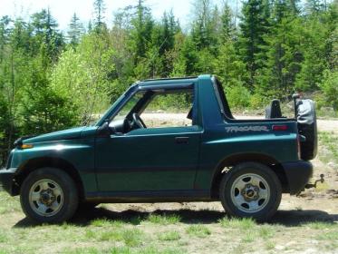

for now this is my ride
a little penny racer lol
