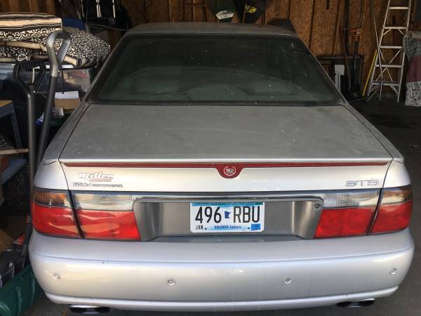

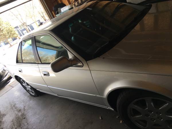

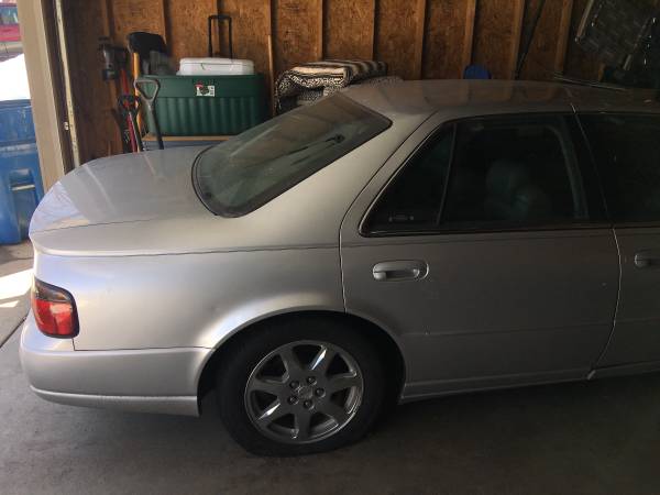

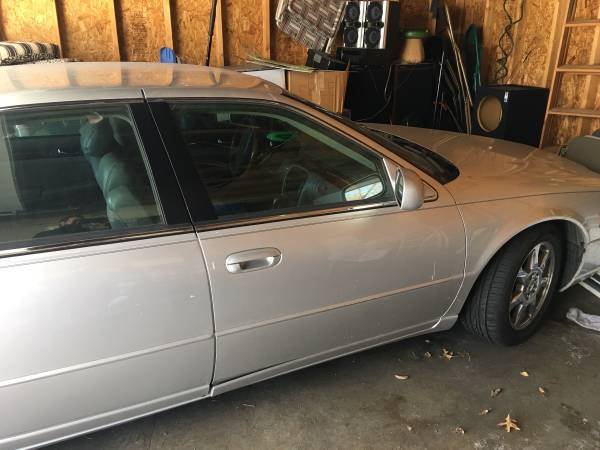

    Thanks much appreciated ...I'm putting the 2001 Lincoln LS on Jack Stands for a few months to rebuild transmission so need a point A to B car and I'm buying this for $400 to GT me to and from work for the next few months ...I'll need your experience and knowledge to figure out the hesitation ...the guy I'm buying it from is getting me codes tomorrow but he said he had them read about 6 months ago and then the caddy sat until just today when he took it to O'Riellys ..the car sat all winter ...garaged at least but he claims the battery was dead and the check engine light was off and didn't come back on until he was home so he is getting me codes tomorrow he thinks it's a misfire code ...I'll find out tomorrow
