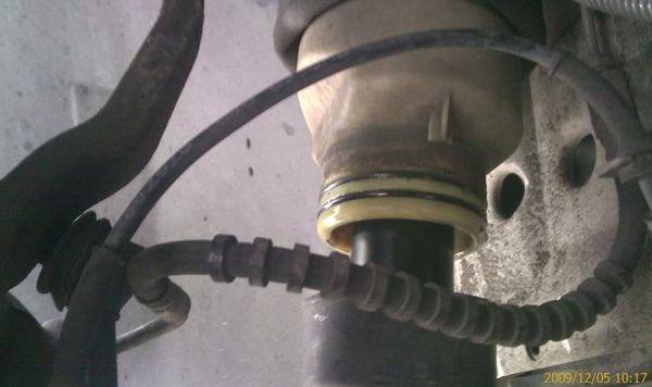

I noticed my air strut has separated from the bottom? Is this normal I have never seen this before. Does it have to be replaced now?:confused:
holy hell! never seen one just come apart. since it came apart id replace it so it didnt happen again.
so why you pulling the comp, cuz with the bag like that the car wont lift
Because it had gone out. This just happen now when I jacked the car up. I guess this explains why the compressor went out again. Oh and this are the bags I had just replaced.
Man that is not good at all. You've got total separation. This would totally cause the airpump to go out. What are you going to do now?
i think the clips broke off of yours, and its too cold for me to run out and check plus im lazy. regardless last thing you want is to hit a bump and have that thing blow out at 60!!
If those were reman or new bags, I would definately be calling the company, for a refund or another set. That should definately not happen.
They were bags from a 98 mark at the wrecking yard. Well no biggie I'm only out of 15 bucks or so. I will just now be converting to coils. I figure it be cheaper and Less maintnace. I have a friend who is giving me his conversion out of his wrecked mark for 250. At this point I will have to replace the 2 front struts, and buy a compressor. so I will spend $250 and call it a day. Hopefully I can get the coil over from him tomorrow thought. If not the mark will be down for a few days till I can get to it.

i wouldnt be driving on that strut if it came apart like that, even if right now it " seems " to be ok, thats a serious accident waiting to happen, but what does my opinion matter lol, see you on the 10 oclock news!!!
I have fixed and used 2 bags like that one separated from the top and one at the bottom never had a problem till they started to leak from the very top by the nut
Believe it or not, The bag holds up air and does not leak at all, I actually turned my air ride off and drove the car around 100 miles and let it sat over night and it stayed up now. But Don't worry Coil conversion go in tomorrow. :) I'm ify about rolling around with the bags like that after I saw it separate. I will let you guys know how it rides after wards, I am keeping all my air stuff just in case I decide to go back to air at a later time.
