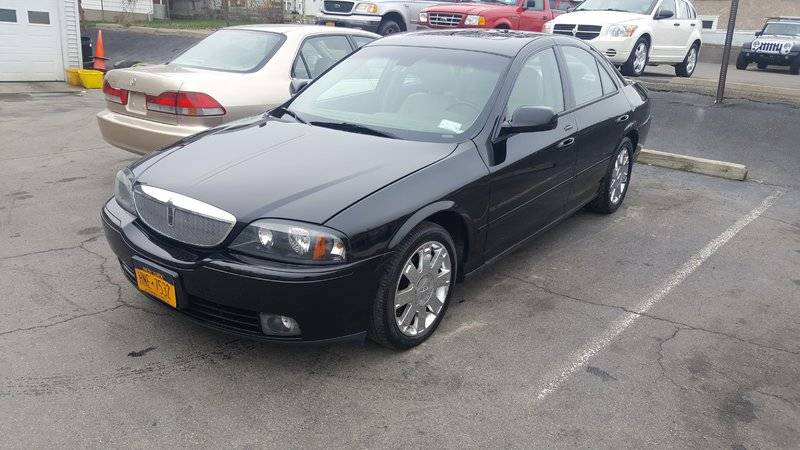

Here is what it looked like when I bought it, after a wash, of course.

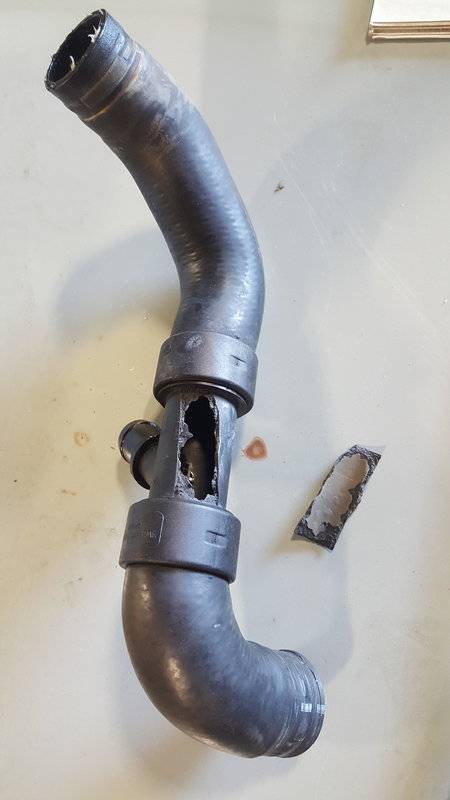

With the engine now happy, I thought I just had cosmetic stuff to do, but a massive upper radiator hose failure dictated otherwise:
That's replaced, and now I finally have time to get the wheels put on it that I hunted down... They are Volvo 18x8 pegasus wheels in the dark grey color. I have always like these wheels and I think they suit the LS perfectly. Tires are Westlake SA07 radials from Amazon in 245/40/18s for $65 each with free shipping (thanks Amazon Prime). I also needed to get 63.4mm to 65.1mm hubcentric spacers and some lug nuts (Amazon.com: 65.1mm OD to 63.4mm ID Circuit Performance Silver Aluminum Hub Centric Rings: Automotive) (Amazon.com: WheelGuard 1957BK, Bulge Acorn Lug Nut, 12mm-1.5, 3/4" (19mm) Hex, Black Chrome Plating (20): Automotive)

Is that an aftermarket grille?
The previous owner 'fixed' the grill by fastening some wire mesh to the front. If you look closely at the pictures you can see a broken vertical slat behind the mesh just to the driver's side of the lincoln emblem. I have plans to replace the broken inner part of the grill with some 10ga perforated steel I have at work, but this doesn't look all that bad from 10 feet away, so I'm not in a hurry.

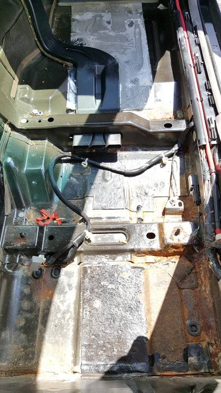

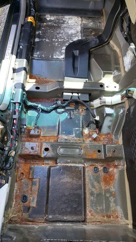

In other news, I took one of the front seats out today to try to get the carpets a little cleaner and found that the leaking sunroof must have been leaking for a long time because even after a couple weeks with no leaks and warm weather to dry the car out, the foam under the carpet was completely soaked. When I lifted up the carpet to get the shop vac in there, water was just dripping right out. Also, the floorboards are really rusty in the low spots, so I'm going to completely remove the carpet on a sunny weekend to clean and dry it out really well, see what I can do about cleaning up the floors, and take measures to prevent the rust from spreading.

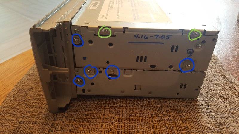

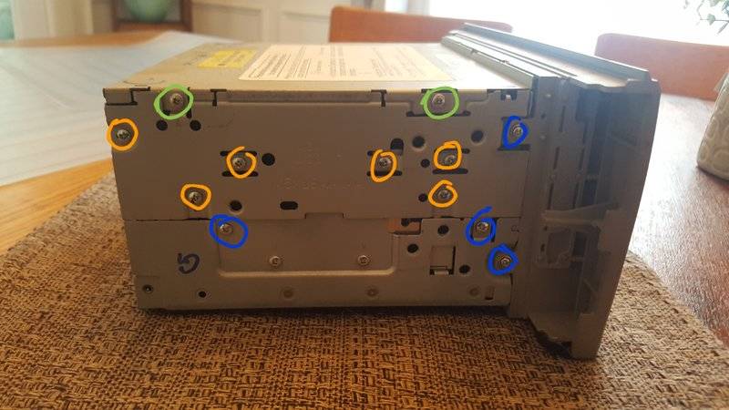

I fixed my CD player! When I bought the car, I couldn't load or eject any CDs and if I tried, it would say CD ERROR in the top left corner, so today I pulled out my head unit and started taking it apart. I won't explain how to remove it because that's been done before, but below is a little bit on how to take it apart. Also, this information will probably only pertain to those cars with navigation.
First, there are 3 Philips head screws holding the head unit in the metal frame that also holds the HVAC controls. Remove those screws so the head unit is all by itself. Below are pictures of both the left and right sides of the unit. The green circles are the screws that hold on the top plate - I removed that first. Take out the screws, lift up on the back, then slide it backward. Then, I removed the screws circled in blue to take the top CD changer module off. You need to roll the touch screen forward a little when doing this. Also, there is a ribbon cable connecting the top and bottom modules together that you need to disconnect. It stretches pretty far, so its fairly easy to do, just be careful. Last, I removed the right side by removing all of the blue circled screws.

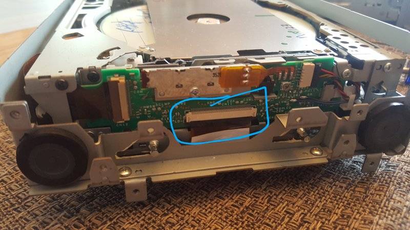

Once the side is off, you have access to another ribbon cable. Mine was simply unplugged. Plug that back in, put everything back where it came from, Bob's your uncle, and it works!
I took the top module completely off, but it may be possible to only remove the side plate and nothing else. If I did this again, I would start with that because then, you wouldn't have to unplug that first ribbon cable. I hope all of you out there with non-functional CD changers are as fortunate as I was.
Once the side is off, you have access to another ribbon cable. Mine was simply unplugged. Plug that back in, put everything back where it came from, Bob's your uncle, and it works!...
Yep, Mine did exact that too. The adhesive on the label on the FFC stuck the FFC to the metal frame there. The part that the FFC plugs into floats, so when it moved enough, it pulled the FFC loose. When it does it again, go in there and take the label off and clean all the adhesive off and then this part should be no more trouble.

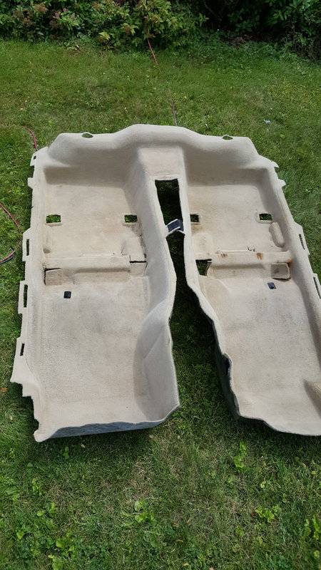

At least I have a nice clean interior though. I took everything out so I could shampoo the carpet. Due to a leaky sunroof, I have some pretty rusty floorboards, but then again I know this car isn't going to last forever.
Before
After
Rust...
Just a note on the CD changer fix, you have to remove the whole top unit because it's almost impossible to plug the ribbon cable into its socket just from the side. Another thing to note, is that the ribbon cable going from the bottom portion to the top was covered in some kind of sticky substance that needed to be cleaned off. This now marks the third time I've taken things apart to plug that ribbon cable in.
... Another thing to note, is that the ribbon cable going from the bottom portion to the top was covered in some kind of sticky substance that needed to be cleaned off. This now marks the third time I've taken things apart to plug that ribbon cable in.
It's the glue from a production label that was on the cable.
