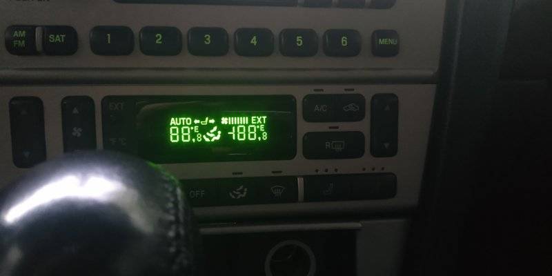

Ok I'll start from the beginning with a self test and scan.
view.php
Scanned car, nothing. No codes.

Is that normal? I had some codes for the Heater valve on mine and then once I fixed that issue I ran the self-test and had the same looking stuff on my screen.
Yes, that's the last part of the test. It's so you can verify that all the elements of the display work.
