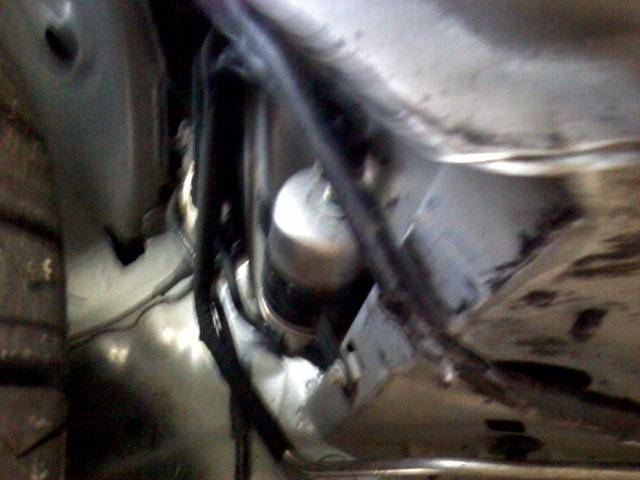

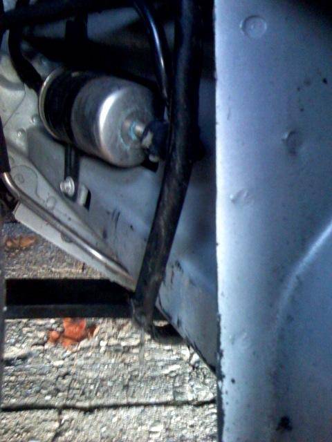

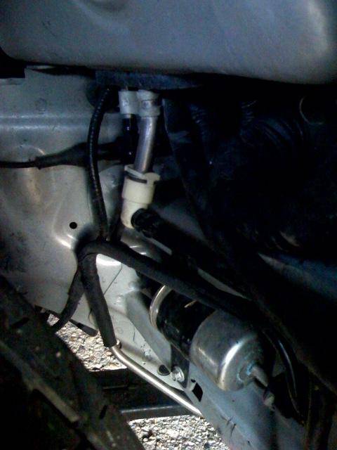

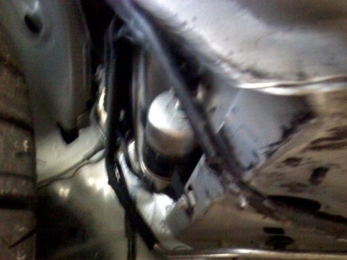

heres the short story.....my friend took my car last night and had a blow out(brand new toyo tires). front driver side blew out. the hose in the pics is shreaded up, not sure what it is for. It looks like a silver hose with black covering around the top. It connects to the white piece in one of the pics.

I believe that is the fuel vapor tube - come from the gas tank into the vapor purge canistor.
It follows the fuel lines from the tank and goes into the canistor on the driver side shock tower in the engine bay.
It's part of the emissions system - so it should be ok to drive as long as it's not leaking - or has a hole in it.
you may be able to plug off each end with a rubber vacuum cap - that would prevent vapor leaking on the hose or a vacuum leak on the canister end.
