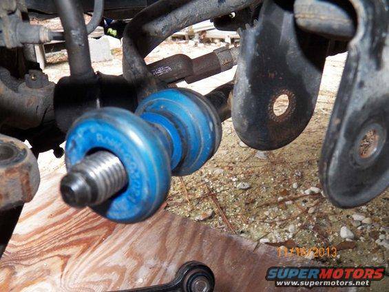

my clunk/rattle was sway bar end links. my blown upper control arm didn't make any noise, it just drove funny.

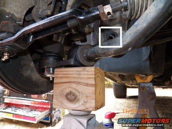

The clunk happened under certain conditions and in another thread I mentioned my bad pass inner and outer tie rods but some investigation turned up bad lower ball joints.

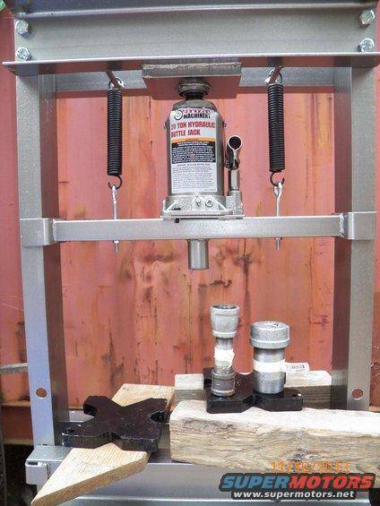

I bought a 20 ton press Monday, put it together tonight and will replace them this weekend.

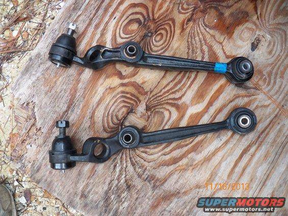

I would just replace the entire LCA instead of press in new balljoints. At least for me, it was nearly the same price to replace the entire arm as it was to replace just the balljoint. Plus, the inner bushing is probably worn a decent amount if the LCA has never been replaced.
Unfortunately the price varied b/t vendors here. I ended up buying the 'cheaper' brand from O'Reilly's at $30.00 each, lifetime warranty. Auto zone had just the ball joints in stock at $26.00 each, one year warranty. Napa only had upper class ones at $69 each. I put the LCAs in a vise, took a large screwdriver and stuck it through the bushings, pulled from side to side and they appeared fine.
Besides, I needed a reason to buy a 20 ton press so buying only the ball joints, my savings went to this. The configuration of 4x4 wood with the press plate on top on the right and the 5/4 deck board with press plate on top on the left worked well. The lower control arm is angled so need to get the right angle to set in on so it presses evenly.

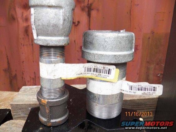

I don't have a bearing press set so I took the ball joints to Ace Hardware and matched sizes. For $25 I had the correct fittings for both pressing out and in. The one on the left is to press out and the right to press in.
Pressed in and ready to be installed.
