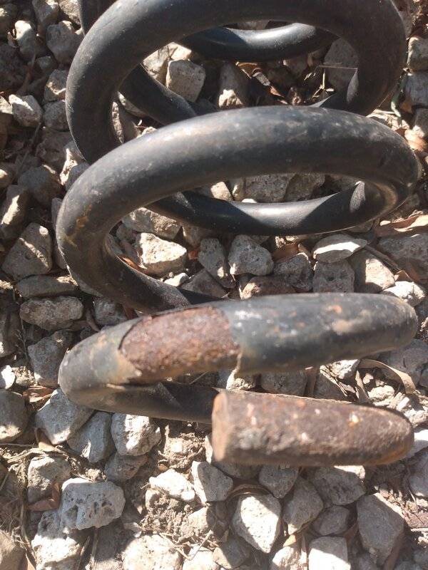

Before you replace the contol arms and/or bushings.... inspect the bottom of the coil springs on the rear shocks.
If you find a bent, cracked, or broken tail on the bottom of the coil springs... you will want to fix that before replacing anything to do with the LCA's.

My point about a potentially broken, cracked, or bent bottom spring tail... was that it will cause premature wear on the new LCA's or replacement bushings.
I've seen a number of coil springs with those issues over the years.
As the springs sag, (wear), over time... the coil above the bottom wrap comes in contact with the end of the spring.
That pressure causes the spring to eventually bend, crack, break at the conatct point.
IF you find a spring with an issue, obviously it will need replacing. It seems the drivers rear is usually the issue.
However... I recommend relpacing everything in "pairs". Yes... it costs more initailly... but how many times do you want to "go back in there" to fix/replace another failed part at a later time?
