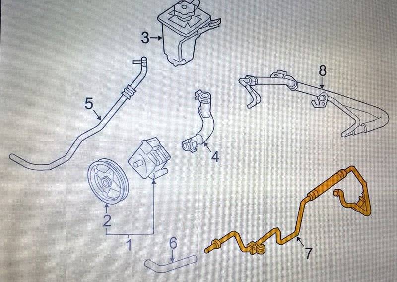

Man was this power steering return hose a pain to find. It's been discontinued and I couldn't find an aftermarket one either. Ford part number is 3W4Z-3A713-AA. Called a Ford dealer who showed online they had it in stock, they didn't, but he gave me the name of 5 dealers in the country that showed they had it in stock. The first two I called had it, list price of $135.xx - When I asked for a discount they gave me about 10% off. The 3rd dealer I called listed it at $140.xx and I was able to get it for $96.xx plus tax/shipping or $114.xx - So it's on it's way. There is another part number that popped up online, looks like the same part, says it's for some V8's (and V6's) but two dealers I asked about it said it wasn't for my 03' LS Sport V8. I'll put the part number up here just in case someone runs across it when replacing their ps return hose. Make sure it's for your car before ordering it though. #5W4Z3A713A
Very doubtful. It isn't just a piece of hose by the looks of it. I've added a drawing above. The shop said they can make some hoses, but not this one.
You could make one or have one made for less than that, very likely.
KS
When you need to move a fluid from one point to another and the pressure is low, as it is in a PS return, the ends matter, but what's in between not so much. It doesn't need to look like that. Just make sure it isn't kinked and can't rub against moving parts. Likely much of that complicated shape is because of assembly concerns and not because it won't move the fluid if it isn't shaped that way. (Attitude and therefore, comment, from an old hot-rodder.)

Yes I understand that cammerfe. Old hot rods usually had quite a bit of room under the hood. As you're aware the LS V8 does not. I imagine that's why the return hose as you mention is shaped that way. Since I was not doing the work myself and the shop I use didn't feel comfortable for probably the reason you mention about making sure it doesn't touch anything, get kinked, in this case I'm a lot more comfortable just using the factory hose, even though as usual they want crazy money for OEM parts. I'm sure some that end up reading this and are more DYI people will appreciate your thoughts on this. Thanks for your help.

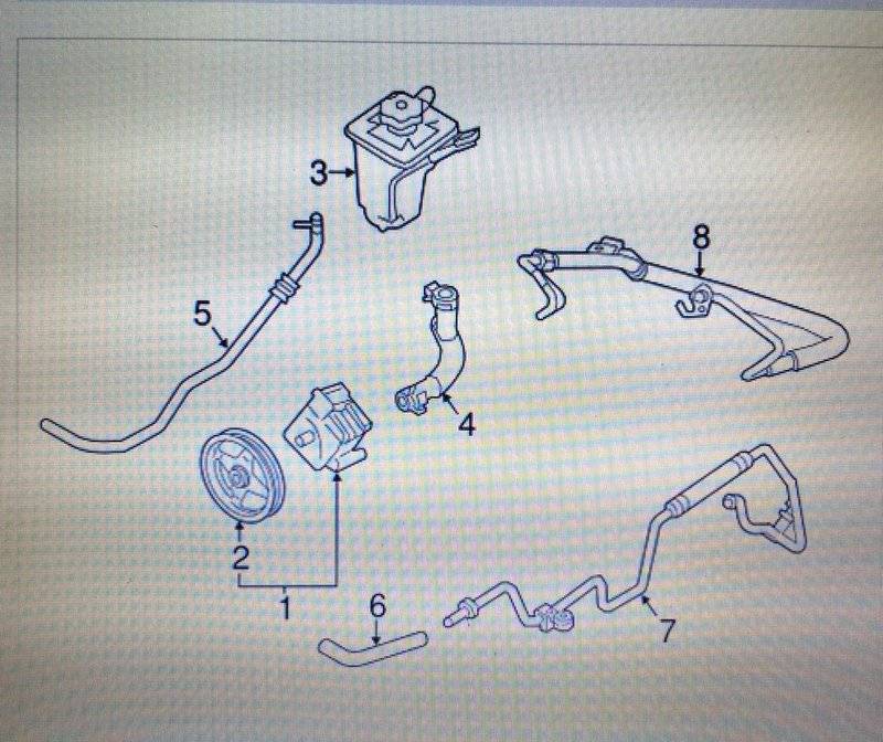

The original part power steering part I ordered ended up being the wrong part that was needed. What is needed is part # 3W4Z3691BA - the reservoir to pump hose. #4 in the photo. Someone checked for me, no Ford dealer in the country has one. (discontinued part) Nothing online, NAPA and a couple other major auto part stores, no aftermarket hose either. Does anyone know if this part can be located? There is a place in town that makes custom hoses, but they need the old hose and that won't be coming off my car until it's replaced with the new one at the shop. (along with ps pump)

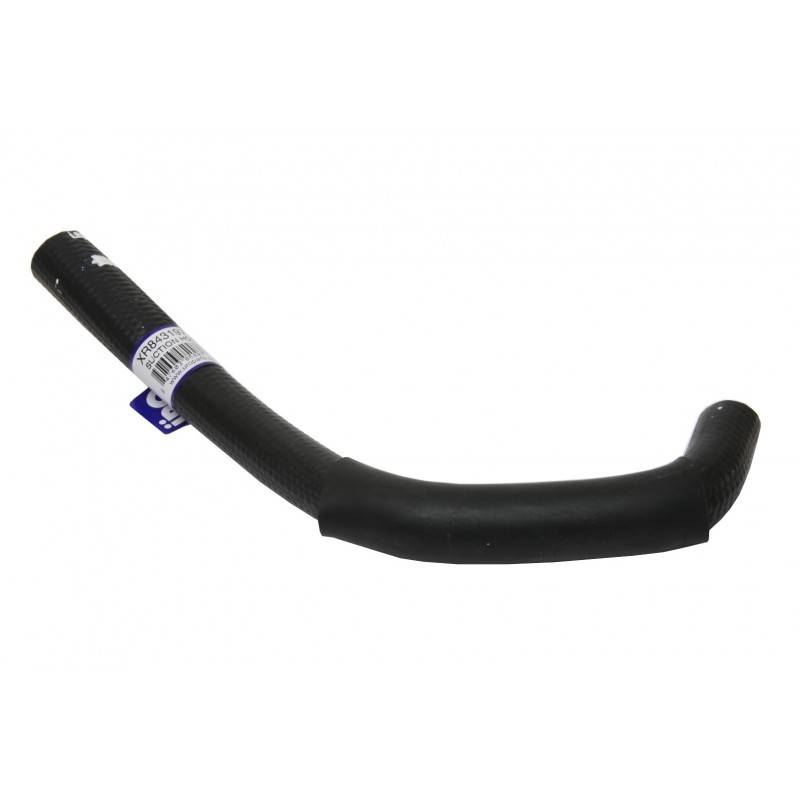

Here is a part for a 03' Jag S-Type 4.2 - URO #XR843197 - Says it's a power steering suction hose from the reservoir to pump. Photo below:
For that one, you can use suitable sized *suction rated* oil-compatible hose. The hydraulic shop will likely have something on the shelf. I'd look up part numbers but I'm on travel right now. Gates and similar make such hoses by the foot. The bends aren't severe, so I wouldn't feel too bad about using normal hose. A bend former might be needed for the lower bend, maybe not.
I added the Jag hose photo the same time you were replying. I thought the Ford hose had some type of ends on them that didn't look like normal hose clamps, is something special required? Is that a 'bend former' on the Jag hose?

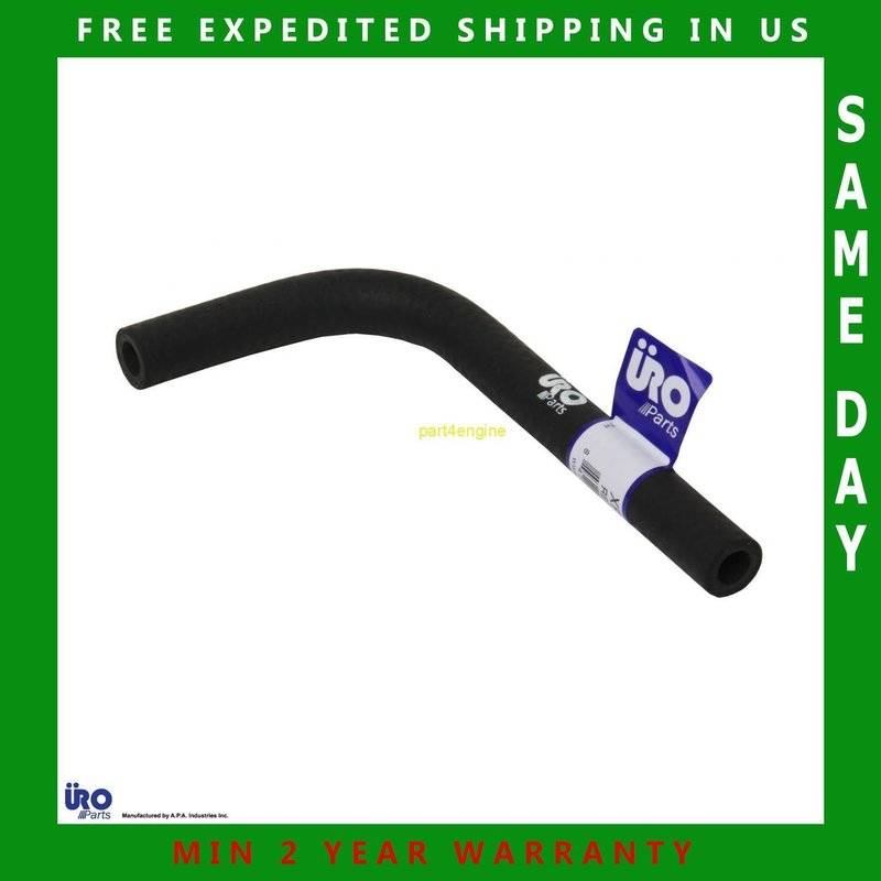

Here is the URO #XR87282 hose for the 2000-2002 S-Type 4.0 - the hose above is for 2003-2007 4.2 - Would one of these work for a 2003 3.9 LS?
So does anyone know if a Jag hose would work? I'm thinking the URO #XR843197 might, but I would like to know before ordering it first. Help anyone? Thank you.

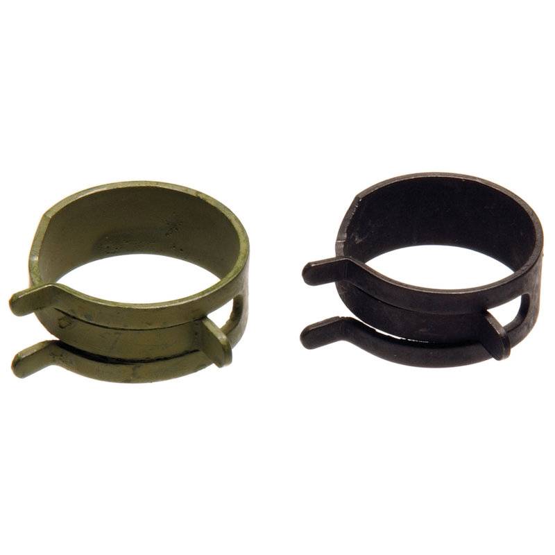

After being told by 2 different shops that I either needed two hoses replaced or a hose and power steering pump, I took it to the shop that replaced my transmission a few months ago. They looked at it and said they thought it was just a slight leak from the reservoir to pump hose and the spring clamp (below) on top had lost it's memory...

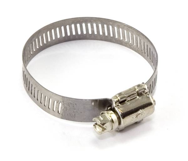

So that clamp came off and a radiator type hose clamp (below) was put on and problem solved. As some on this site have called a lot of 'mechanics,' parts replacers. Instead of fixing the actual problem, just pile up the bill by saying something like the ps pump needs to be replaced, etc. Is it they are that bad of a mechanic, lazy or just trying to run up the bills to people who trust them and that they know what they're talking about?

And it appears that the Jaguar hose URO #XR843197 is not the same as at least what the hose is on my car. My hose was was maybe 24mm at the top and 16mm at the bottom. The jag hose was the same size (16mm?) on both ends.
