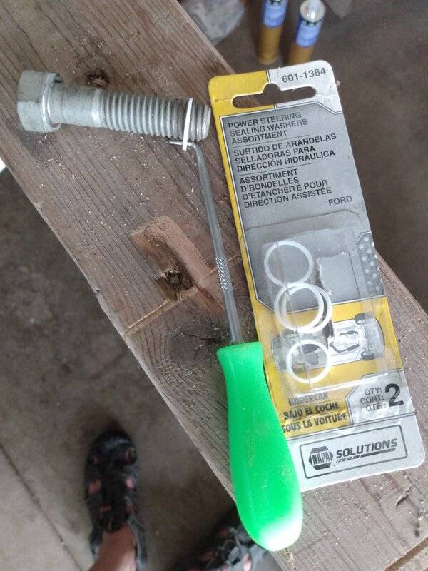

There should be no "stretching" or "scrunching". Get some hot tap water, (hot as you can get it), and put the seal in it for a few minutes.
Then... start by putting one side of the seal on the threads of the hose fitting... and use a small hook tool to walk the seal around the threads... until it gets past them to the seat is on the fitting. Don't roll or twist the seal while doing tjis
Let the seal cool for a few minutes... and it will shrink back down to size.
Pic is a simulation... using a bolt in place of the fitting.

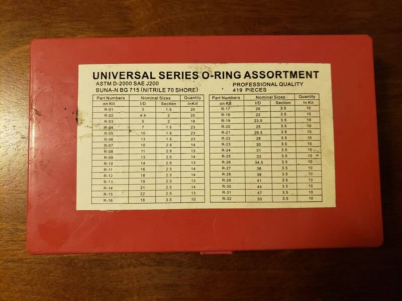

In the mean time, I decided to tackle this problem by using my stock/collection of o-rings.I work on Japanese motorcycle as well, so I have stock of o-rings, from small to big. They are also metric, so I'm hoping I can find at least something close. I have sets of black, green, red and white (Teflon rings/seals) so hopefully, I have what I need. No, I'm not worried about the diameter. I'm worried about the thickness of the rings.

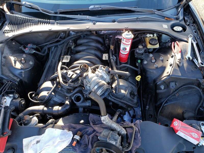

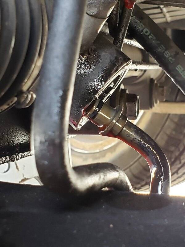

First, remove the electrical connector at the pressure switch. Put some kind of pan under the rack where power steering hose connect. There's one bolt holding two hoses. This bolt is 10mm and it's not really tight. When you get the bolt out, take only the top hose, which should be your pressure hose. It has a plate to hold the lower hose, which is your return. Don't touch the lower return hose. Just leave it in the rack. You really don't need to take this hose out. Just the top, pressure hose. This what pressure hose end look like. Notice the retainer.
By mistake, I took off the lower return side. Don't take this out. Otherwise, you need to replace the o-ring. One less item that you need to worry and one less step. This is the return side.

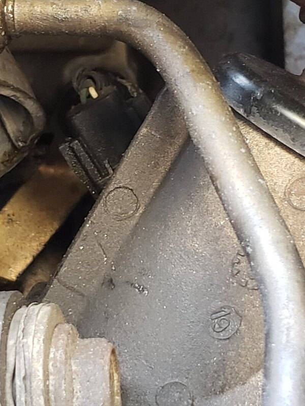

It's very hard to make out, but behind that plastic connector, there's a metal bracket holding the pressure hose. You do not need to disconnect this connector, but need wobble-head to remove the bolt, which is 13mm and slide the bracket out from the stud.

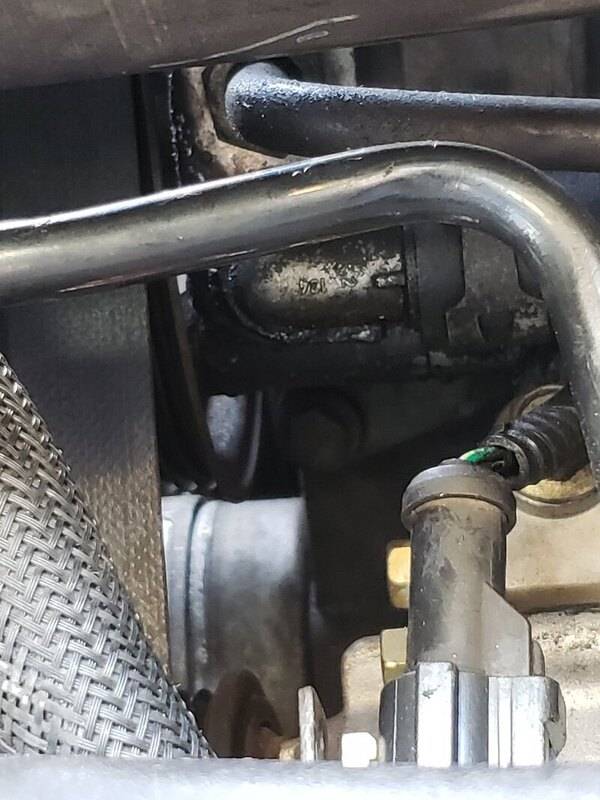

Again, it's very hard to make out, but at the top of picture, there's a metal tube with lots of black gunk on it (above the 90 degree bent metal tube). This is the pump side of the pressure hose and the fitting is 18mm. At this point, it did not look like I can get the wrench on the hose fitting, so decided to take the 1. intake tube, filter and the block-off plate. I have K&N filter kit, so those of you who have stock airbox may need to remove the whole setup, front of throttle body. 2. power steering fluid reservoir so I can get more needed space. But no matter what I do, I could not get the wrench on the fitting. At this point, my only option was to pull the power steering pump out with this hose connected so I can take the switch off.

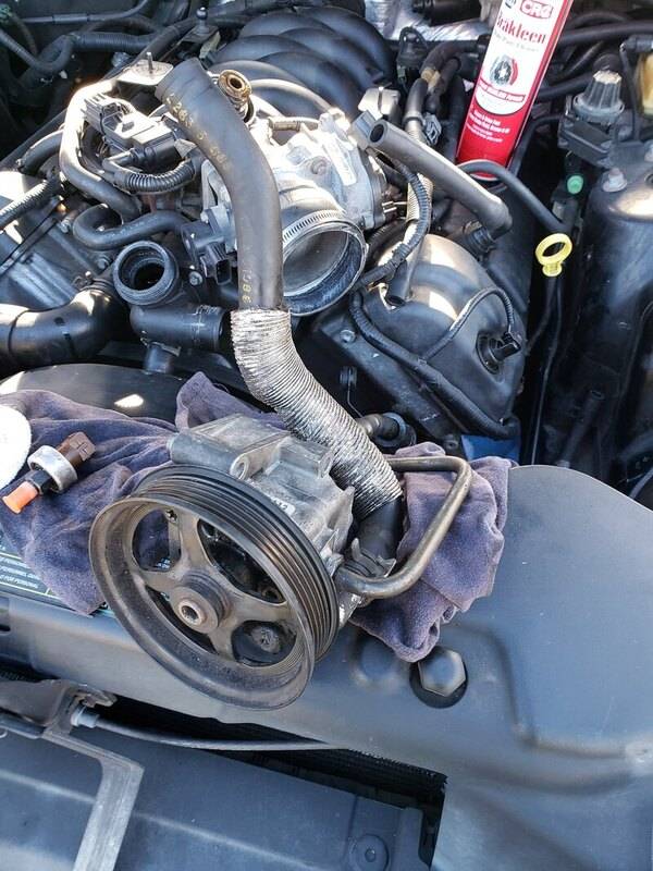

As you can see, lower radiator hose remove to give me room to pull out the pump, and the bad bad sensor on it's left.
If I knew it was going to be this big of a job, I would've bought a Ford sensor (let this be a lesson to those of you who need to change this switch!) but instead, I bought a cheap Chinese one. Well, at least I know how to change the switch now!

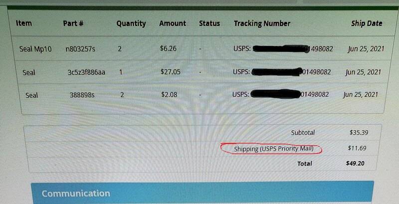

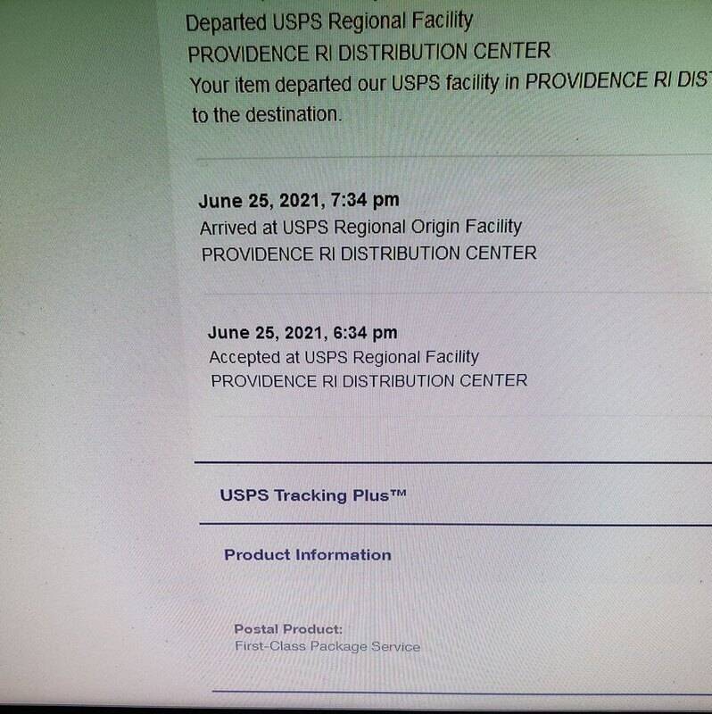

So, I finally heard back from Tasca. I had to send them message to find out what happened to my order. Anyway, they finally said it's ready to go out, and got myself a tracking #. Everything sounds, right? Well, let me show you guys this. And mind you, these are o-rings for the steering lines, so you can imagine how big it is (or rather, how small).
Paid Priority Mail. just look at that price. You kidding me? Anyway, I'm used to swallowing this kind of rip-off shipping anyway.
Tracking said otherwise.
I'll wait to see what they sent me with.

I'm not talking about the shipping time. I', talking about the shipping charge and method. Anyway, like I said, I'm used to it already....................
