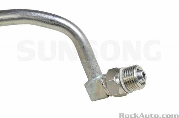

    Ran out of time. Reinstalled my old a/c compressor and had it recharged. Still leaking and $148 out of pocket now. I'm going to try again next weekend. Here's a picture of the hose end. Cutting the tube and sticking deep well socket over it seems viable.

    Again, I’m not familiar with the setup or location, but if the situation allows, some penetrating oil, some heat, and if possible, a piece of pipe on the wrench might get it loose.
    Don’t just try to turn the nut out. Also try to tighten it in a bit. Then loosen it a bit.
