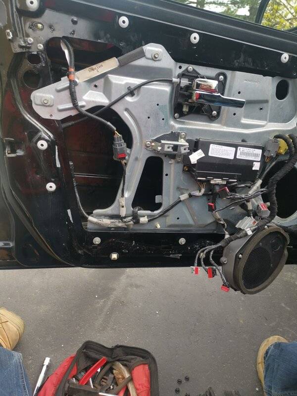

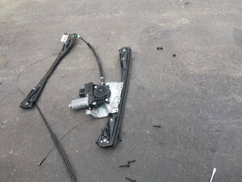

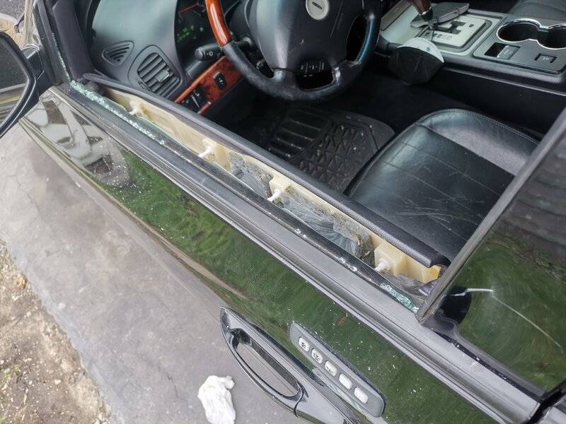

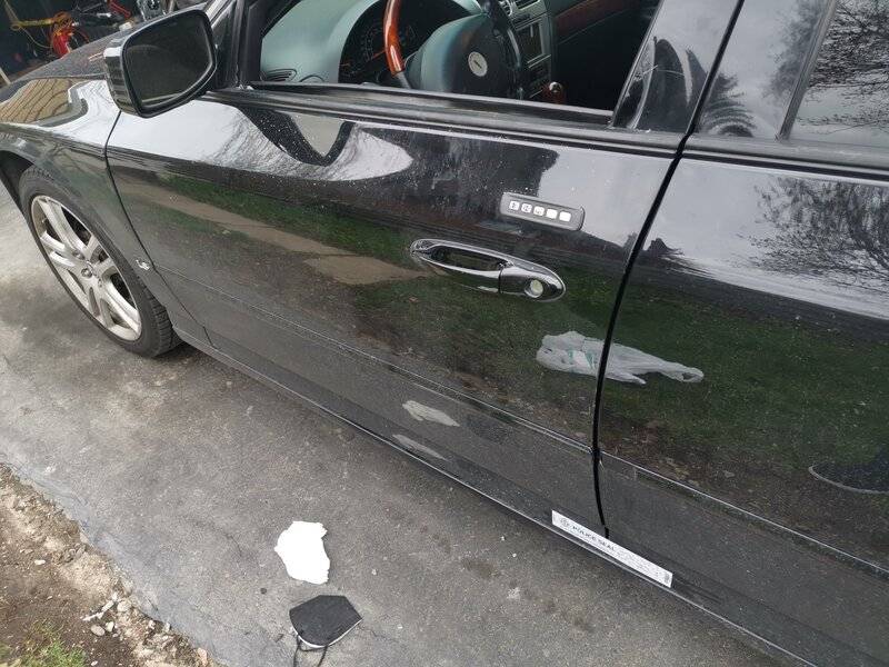

06 Lincoln @ 156k km loud whining sound when turning the wheel plus loss of reddish brown fluid , suspected power steering leak, took car in to local ford dealership. Service request concurs with my assessment (powers steering fluid leak) but dealership opted to pass on repair due to lack of replacement parts. Took car in for service on whim but I would appreciate advice on difficulty of replacement on high pressure and other miscellaneous power steering lines. I have yet to locate point of leak but as a side note, my LS was stolen mid April from my place of employment and recovered a day later. These jokers stole spare change including my box of cleaning supplies, the battery and full size jaguar spare wheel and basically vandalised the interior... I digress but have nonetheless included pictures of some of the damage and my replacement of the drivers side window and regulator. Any advice on steering fluid line parts, cost and scope of replacement would be appreciated...
Don't throw that regulator away if it still fixable. Had the window go out in my car and I bought two new ones and they were both junk, I ended up having to take my original one in to get rebuilt.
