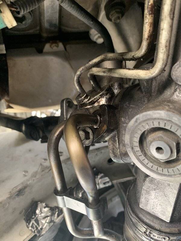

I have a PS leak that appears to be coming from the hose connections on the rack.

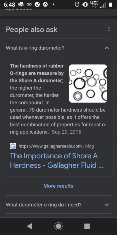

As I suggested... unbolt the line and pull the o-ring off. If it's black... it's a standard o-ring you can get from your local parts store that has an o-ring kit. If it is a different color... it may be a different compound or durometer... and you may have to find an industrial shop vendor that specializes in o-rings. Or... try your local dealer... not Ford Parts.
I replaced both of the O-rings at the rack. Of course the 3F886 that I bought on line wasn’t the right one and was too big. Fortunately, Autozone had a pack that included a good match.
BUT…I still have a leak! When I refilled and did the air purge procedure, I noticed what appeared to be a slight spray originating from underneath the PS unit. It Doesn’t appear to be a continuous spray more like it squirted toward the front right of the car.

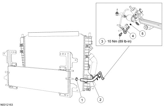

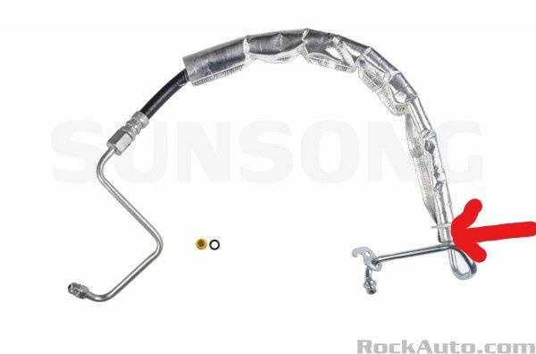

So this PS leak is illusive. It definitely is NOT coming from the sensor, it is bone dry. I think it is coming from the high pressure hose where the hose connects from the hard tube to the rubber part that is covered by the heat protector. IOWs, not right at the rack but at where the high pressure solid tube meets the rubber part.

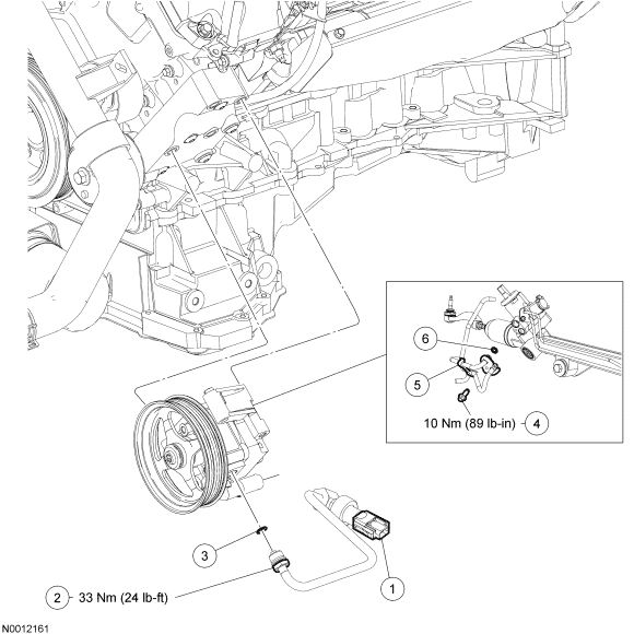

I finally got the PS high pressure hose changed out this weekend. What a B*T*H to deal with!!! The attachment to the pump was the biggest pain. I was very close to moving the entire A/C compressor. Fortunately, after moving the brake lines out of the way by removing the radiator top mount, I was able to get a flare nut wrench on it and get it loosened. Then figuring out the best way to pull it out was a challenge.
Then, getting the new hose in was equally as challenging. There are two options for routing the hose. One allows for enough room so that the metal hose has enough room to get the fitting into the pump...the other option does not!!! Of course I worked on the wrong option for a while until I figured out a better routing. These are the frustrating aspects of the service manuals. They give you the bare minimum of information and then you are left to your own devices to figure out how to actually accomplish the repair.
Anyway, I got the hose in and it is bone dry underneath with no PS leaks!
