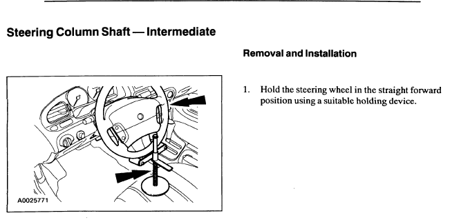

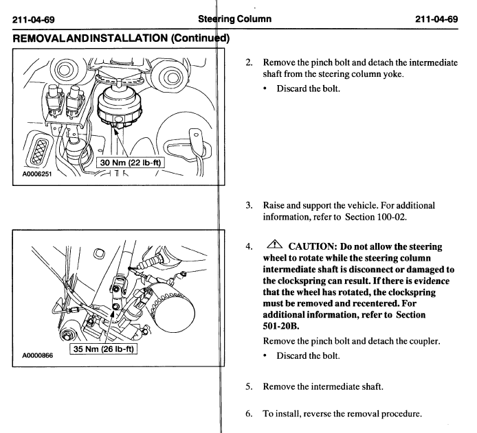

Ahhh, I see it. That's probably the case. I'm guessing it's not easy to get to it though. Would I need to tear the dash apart to get to the column?
Interesting. The tech manual I have isn't as detailed as what you gave. Thanks. I'll take a look at it tomorrow morning.
