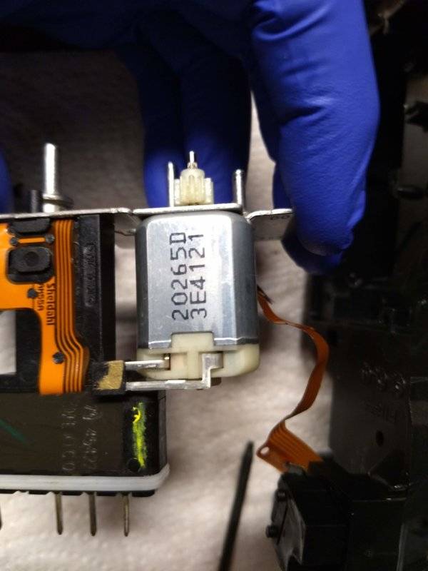

Has anyone sourced the little electric motor in the door lock actuator? I completely disassembled one and I think that the motor has no torque left in it. Body is 18mm x 24mm x 30mm. Shaft is 2 mm x 15mm to the body. There are splines on the shaft for the gear and the end has two threaded holes for mounting.

Update. I wanted to see if it was indeed the motors that were the problem on my week door lock actuators. After searching for a replacement motor that would work I gave up on a exact fit and ordered the FC280 20150 motors commonly used to fix the door lock actuators from the Lexus and other vehicles. I have fixed two doors so far and they work fantastic now. The old motors were definitely the problem in my case. I will post a tutorial with pictures in the near future of the process for anyone who is interested in doing this instead of replacing the whole actuators.
