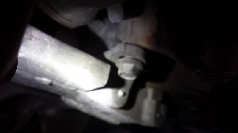

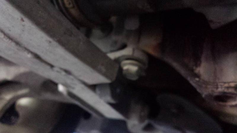

I just got a poping noise coming from im pretty sure the front suspension. I just pops once not a bunch of times at once. I can feel it through the pedal. I just got under it and checked all my ball joints and tie rod ends, control arm bushings. Dont see any play. It happens if im driving down a road and kinda swerve left and right it happens when I turn left. I say these bolts that look loose but there not. Wondering if there suppose to be like this. Any suggetions. I just rotated my tires and changed my sway bar end links last weekend. My motor mounts are leaking too. Im thinking it might be that too.

DON'T TIGHTEN THOSE !!!!!!!!!!!
Those are locater bolts and they are supposed to be like that. I had a clunk coming from front of my car that I couldn't diagnose, and I tried tightening these locater bolts up and sheered the nut right off of the driver side one. Had to pay a good chunk of change to have it removed and replaced.
I came to find that my clunking is from blown out shocks and springs. I'll be installing Eibach pros and new shocks this spring.
Good luck, but don't tighten those bolts.
Yeah I didnt tighten them and I remember someone saying something about them in a recent post I just couldnt find it. I figured out my problem. My end link is junk I just installed on the driver side. If I jack the front left wheel off the ground then lower it I can see it pop. I just greased it and it actually made it worse.
