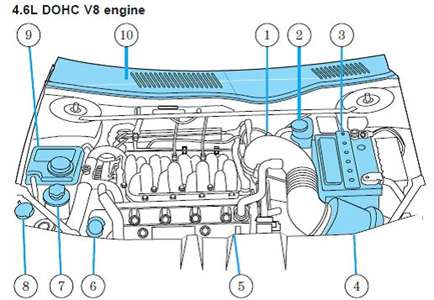

This is a shot in the dark and hopefully someone more knowledgeable jumps in, but maybe something with the connector on the trans? On this image:
follow (1) down to top of trans. Should be some connectors there. Check if the connector(s) is loose. Also, anywhere you see actual wires poking out beyond the protective sleeves, see if any are chewed on, been knicked, etc. If you see any BARE metal from the actual wires, something has been chewing on it, or possibly a botched repair in the past exposed them.
If it were my car and it was getting funky trans issues all of a sudden, that's probably where I'd look 1st. There might be a sensor or two around there on trans that might be spitting out wrong info, causing the car to think it's in the wrong gear, etc. Hopefully someone else knows more.

That sensor on image is the Neutral safety switch, I replaced this part and did as you have suggested yesterday, checked that the plug was in tact, and with no loose wires. Everything is okay. What I will check is the ecu pin grounds maybe those have gone bad over time. I will do so once it stops raining so much here in Florida as I do work out in the open, and I already am sick for getting wet the other day doing an engine swap on a 89 5.0
