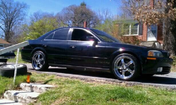

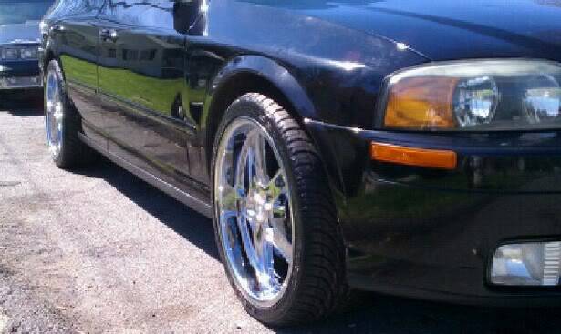

Heres a few pics this is before going back and painting calipers. Ill have better pics this weekend.. Im very happy with the wheel for the price just wish it would have fit w/o modifications..
