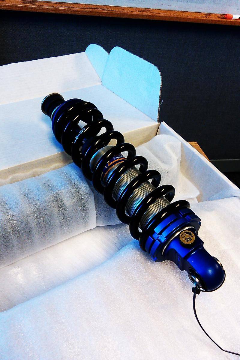

I just did a similar project on my Esprit - custom GAZ adjustable coilovers and they designed my springs to my spec. Figuring out what the spec needed to be took a lot of thought - I added a APR GTC-200 adjustable wing to the rear and some canards on the front - so I needed to increase the spring rate to work with the higher downforce.
I don't have the answers on the stock LS spring rate - but most places with a hydralic spring compressor should be able to tell you - putting one on the bench and squeezing it...
