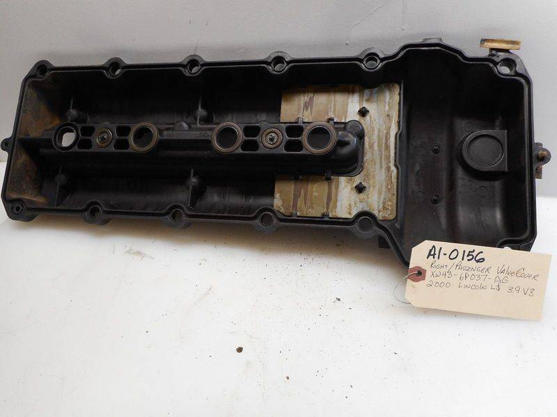

      When oil leaks past the valve cover gasket it drips onto the exhaust manifold. If it's bad enough and you run the engine long enough (30 minutes highway speeds was more than enough for me), you will see some smoke. You can easily check if this is the case by looking for visible leaks down from the cover to the exhaust manifold. If you have smoke they should be visible. As per usual, "what Joe said".
      That's exactly what it is:
      See the "white" U shaped cover here?
      Under that it's all steel mesh, and on the other side of the case, there's a hole for the tubing. It's rudimentary simple (because Joe got mad at us...) for sure, especially for such an otherwise over-engineered car, but accomplishes the same goals as a valve. Balancing loss of manifold vacuum with the flow of crankcase fumes is probably achieved by the relative small orifice size, combined with steadier intake manifold pulses than other cars. As for backfire flames, steel mesh (or any porous metal filter) is perfect at extinguishing flame fronts. I'm just happy we don't have another part to change/maintain. :)
      You can clean the PVC pipes in your house however you want... :D
      but the PCV system in the LS doesn't really need much maintenance, AFAIK. It would be very difficult for that 1-inch wide hose to plug up, but feel free to remove it and clean it as it's probably drenched in condensed oil vapours. Wish it had a catch can for that. There's not much to plug up that steel mesh either.

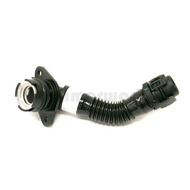

          The updated "breathing" of the N55 must have changed things. Here's my $38 replacement:
          On a side note, I'm quite surprised that replacement parts for my 535i's aren't that expensive at all. And my dealer betters the prices of the independent about a mile away. Heck, my net cost for a dealer oil change is only $10 (they do it for $99 and parts would cost me $89; it takes a LOT of oil)! After about 60K miles (40K on the 2012 and 25K on the 2014) I couldn't be happier. We just did a 5600+ road trip (we were in your neck of the woods for a "fly-by") and the car said I averaged 29.8mpg. I did a hand calculation and got over 32mpg! Not bad considering my driving style!
          Even though the BMW is built to a much higher quality I do miss the LS. It was fun to drive, but when I discovered I had the last 4 good (Motorcracft) shocks, the writing was on the wall. Kudos to you guys that can keep your LSes on the road and repaired correctly!

          Glad to know they made improvements over the E46. The parts cost wasn't an issue, all the work that it took to get to it to replace it was (remove alternator, power steering pump, oil filter housing, ...). Also, it had several connections, and all were potential leak points.

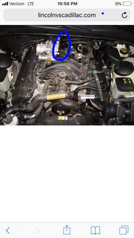

          Where exactly are these gaskets you’re talking about? I think I have a vacuum leak and this sounds like a place I haven’t checked.. want to check everything I can before I take a look at the intake manifold gaskets (the ones you mean when you said “the metal ones between the intake and the block”?).
          Here’s my post: 02 3.9L LS troubleshoot

          Is this where you’re taking about?
