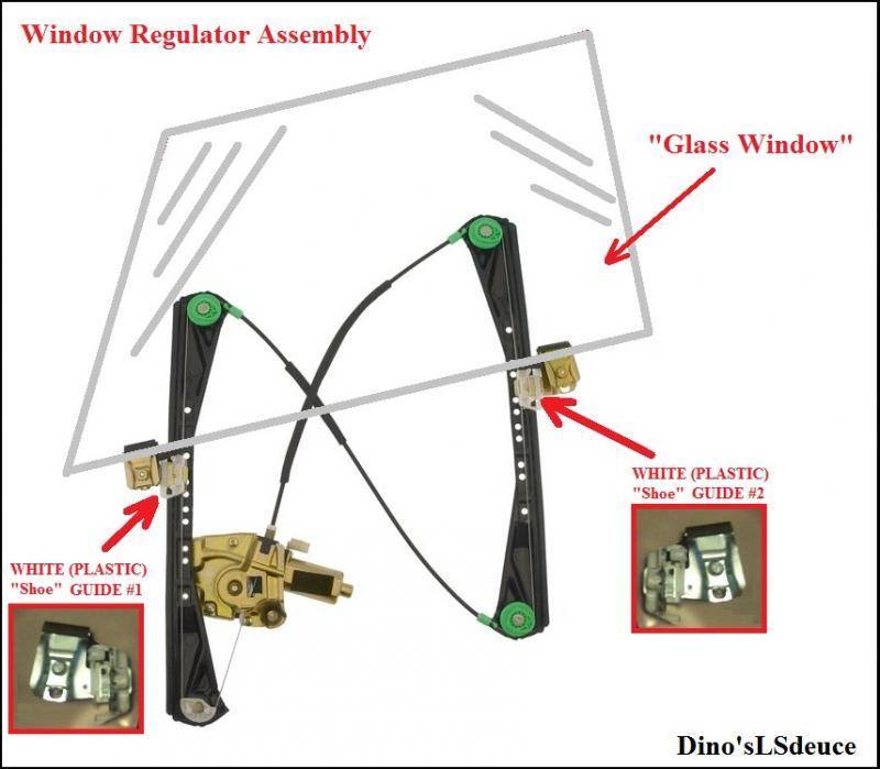

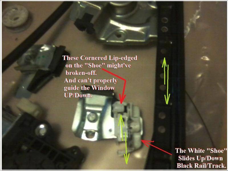

Hopefully you can replace those "Guide Clips" But, if you find other damaged plastic parts -or- a problem with the Motor itself -or- snapped the cable, etc...? ...You could purchase a full replacement "window regulator" and framing from Amazon. Just figure out what pieces are damaged. But, just as Jiovanni12 said, it's more than likely the "Guides".

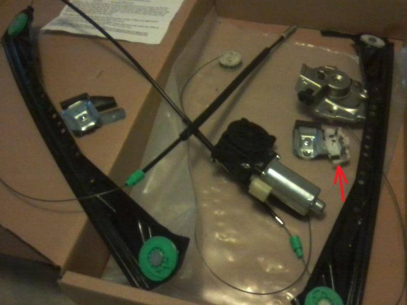

I did both sides (drivers & passengers). Pretty easy once you do one. *Hint... Just don't foget to "re-plug" the electrical harness to the motor. I forgot both times !!! pretty funny. had to remove the whole thing again.
====>> If someone needs a "detailed" picture of the window regulator, parts and framing assembly ???
I still have my old one, that I could take pics of for anyone who needs it, for whatever. If so, Reply.
Tore into door panel today and the white plastic clips are indeed bad, followed link provided and I'm good to go thank you ebay, now hurry up and wait!
