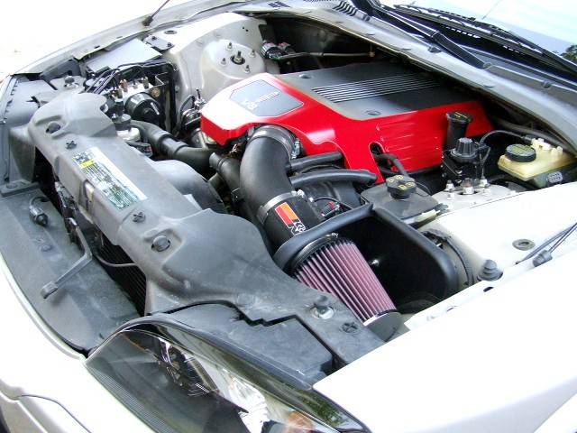

Extra brake caliper high temp paint with too much time on my hands.
Took the cover off, washed it, wiped it down with alcohol, masked it off, and painted it with a couple of coats with 5 min. dry time in between. Took all of one hour including dry time.
I like that a lot! Isn't the 03+ LS engine cover smoother than the 00-02 cover? When I had mine painted the cover had a texture to it which made it a little harder to look right.
GCWimmer's engine cover looks great. I would take it a step further by (1) washing the engine comparment (its filthy), and (2) getting a set of strut tower covers from LSK and painting those to match! :D
That looks great, and red as well. It would look good on my red car.
A couple of questions, for you GC, How long has it been painted, and are there any problems with flaking, or chipping?

Good idea Todd! ;)
WOW, that looks really good! Not over the top; just right! Now you just need to throw some dressing on the plastic to complete the look:D

Looks good, GC!!
that looks really nice... im gonna have to try something like that with mine to make it stand out...

It has been a year now and no worst for wear looks the same as day one. Make sure you use high temperature pain like engine, caliper. The photos were taken at the time I painted it and I have washed the engine compartment since.
