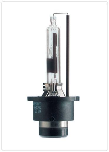

Sorry for the HID thread. I'm using 8k 35w bulbs from DDM in my lows and of course there is some glare, enough to get flashed by some people every few nights. Is it a good idea to get some flat grey high-temp paint and paint the tips of bulbs to help reduce glare, or just get higher quality halogens? I'm tinting my headlights soon, but the tint won't be dark enough to reduce much, if any light output. I don't know what to do.

I thought about painting the whole bulb, but the bulb's temperature would probably get too high. That's why I'm thinking of just the tips in a flat grey and not a flat black(heat).
I'd imagine using high-temp paint would work just fine. Paint the bulb the way a D2R is, and perhaps even a little more later on if it doesn't yield good enough results, to cover the capsule from underneath (vs just the two stripes on the side):

I WOULD NOT PAINT THE BULBS! You shouldn't even so much as handle them with bare hands let alone paint them. They are costly to replace as well.
