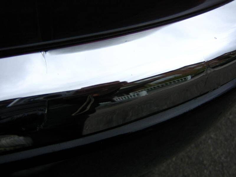

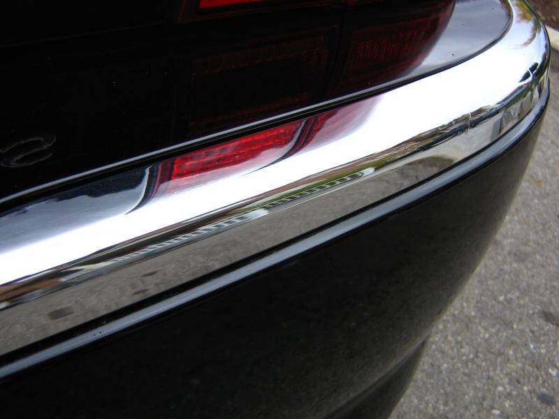

i want to paint both front and rear chrome parts (not sure what they are called) what options do i have? I was thinking i could just buy some spray paint but will it last? should i sand off the chrome first?
how can i pull these parts off? do i have to take off the bumpers?

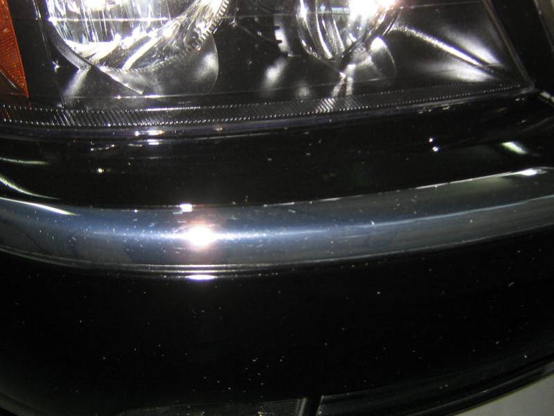

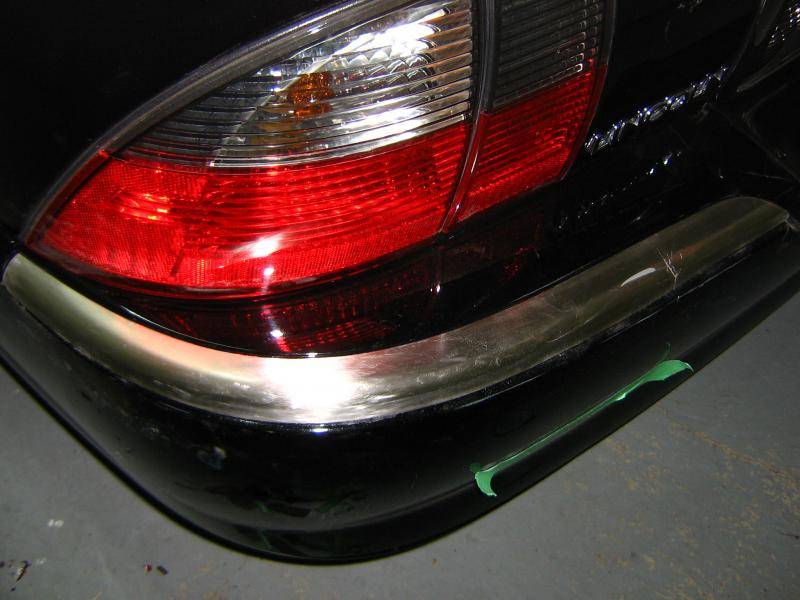

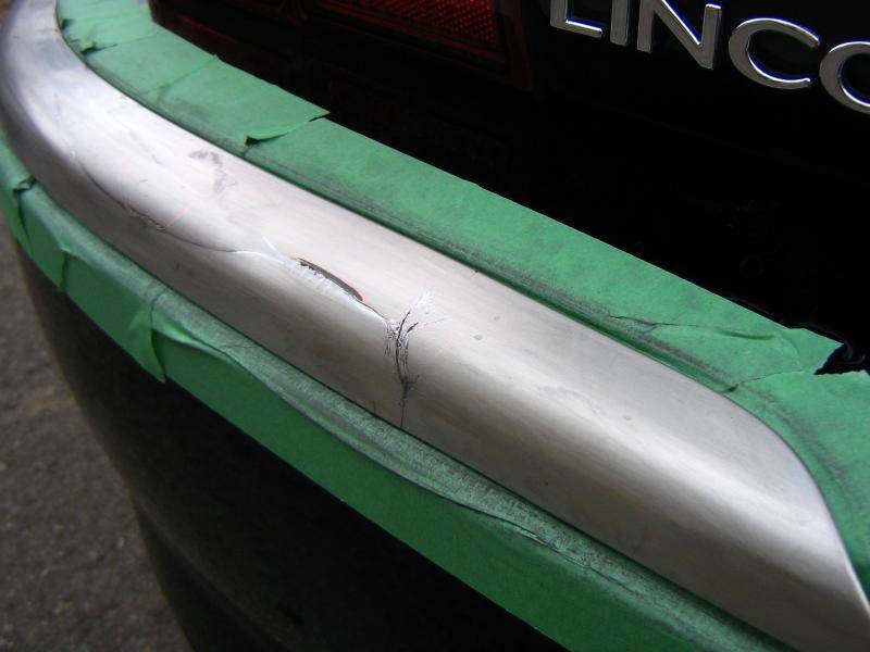

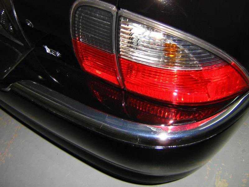

before
before
before

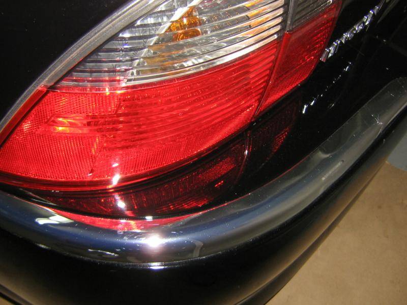

after

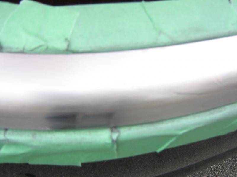

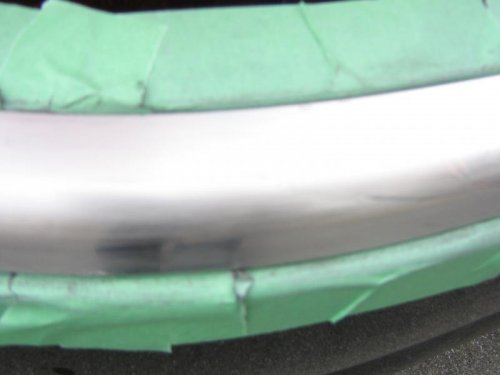

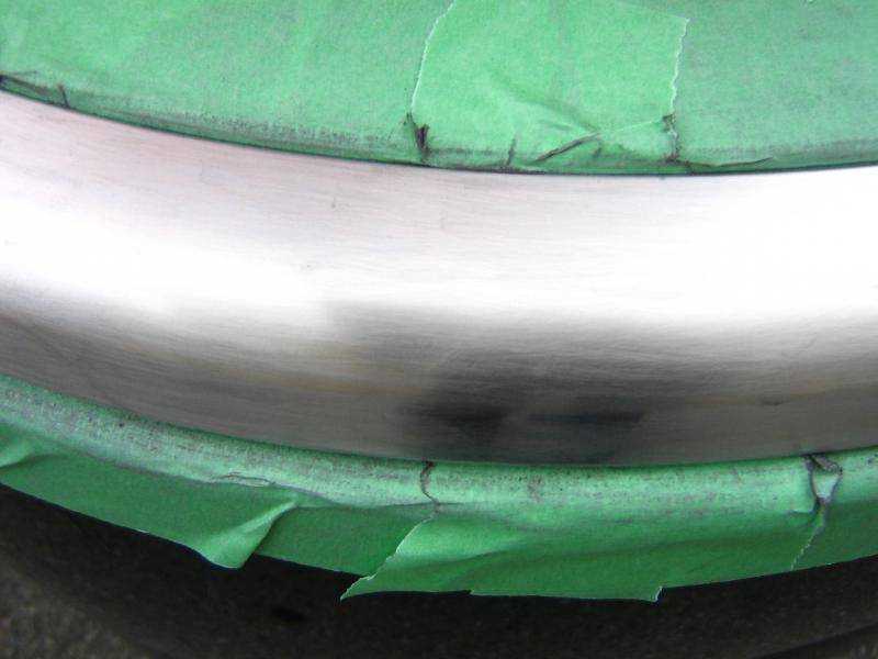

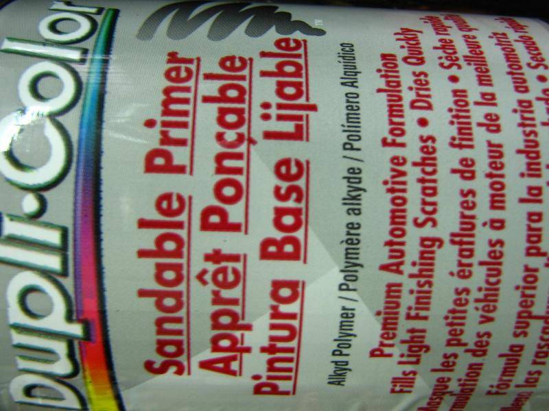

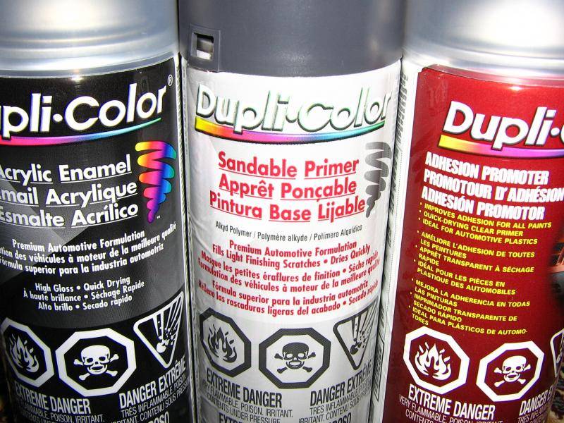

sanded with 400,600,800 sand paper now ready to addhesion promoter,prime,paint,and clear coat
cannot find adhesion promoter what if i skip this step?
The paint will probably flake off eventually. Have you tried Cdn Tire and NAPA? C'mon you live in the GTA, phone around.

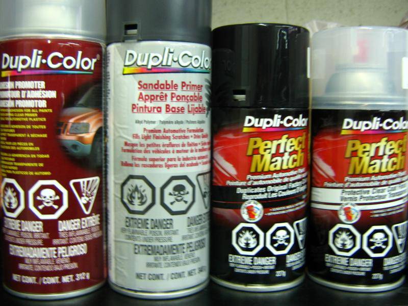

ok got it all from the local Canadian tire except the paint they didnt have anymore black ford left could i use the black they have for Honda or Chrysler?
whats the black OEM paint called on these cars they had blackburn black misca black and metallic black
i returned the bottle on the far left side Acrylic Enamel it wasn't an actual clear coat just a high glass and got actual clear coat
