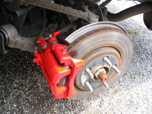

I took the easy route and painted them on the car. I masked everything including inside the wheelwell and the fenders. I then use brake cleaner and a good brush to clean the calipers. I think I used 3 coats of red and 2 clear. I think it came out nice.
I was going to get a color to match, but decided to use the standard bright red to stand out and grab attention. It also blends in the huge tail lights so prominent on the older LS models.
