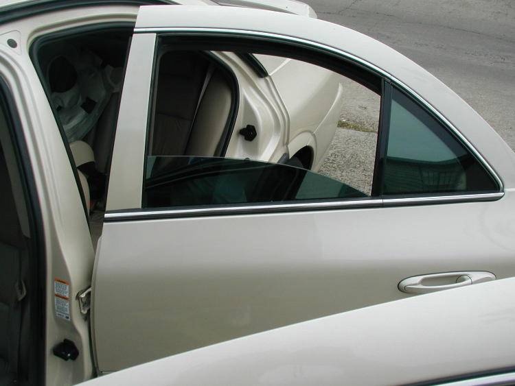

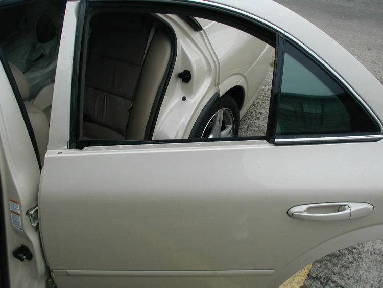

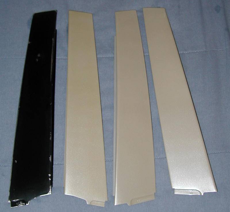

I finally got around to painting the b-pillars (3 out of 4). I took them off the car on Sunday, pain in the a$$ to get the backs off. Had to take the back windows out to get the b-pillars off. The one that is not painted has a dent in it and needs a little body work this weekend.

Had a slight problem with the paint, used a clear coat that has a kind of yellowish tint to it for some reason (who knows what it was). I put them on and they didn't match very well. I had enough paint to sand one down and do it again with a different clear coat. Much better match. I ended up having to order more base coat to finish the other 3 b-pillars. I will have those inst. for you soon hopefully.

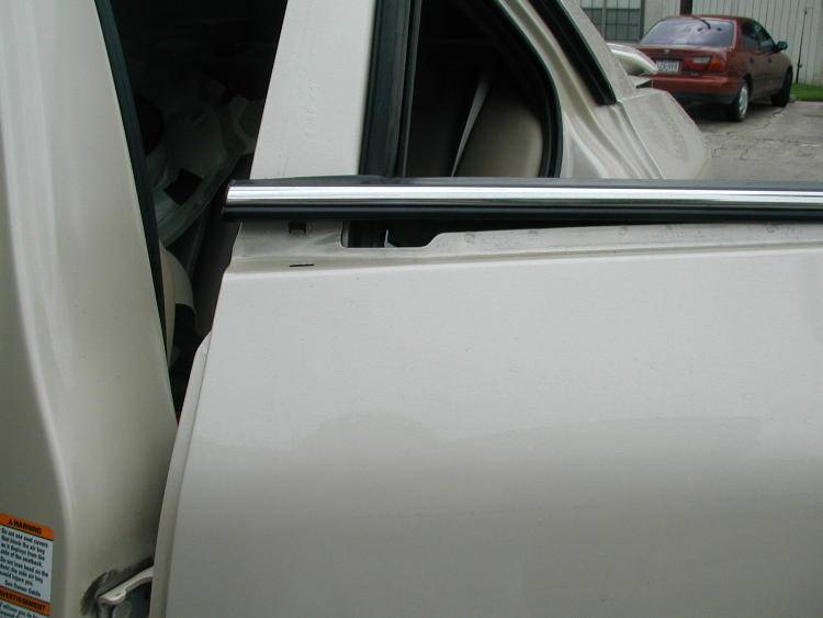

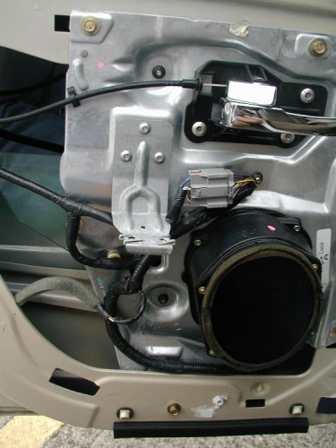

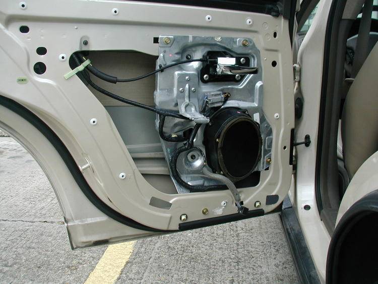

How to:
Roll the window all the way down and pull up on the window trim.
Once the trim is up, slide it towards the front of the car to remove from the door.

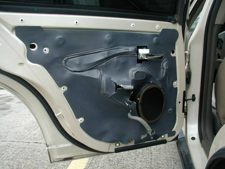

Remove the door panel.

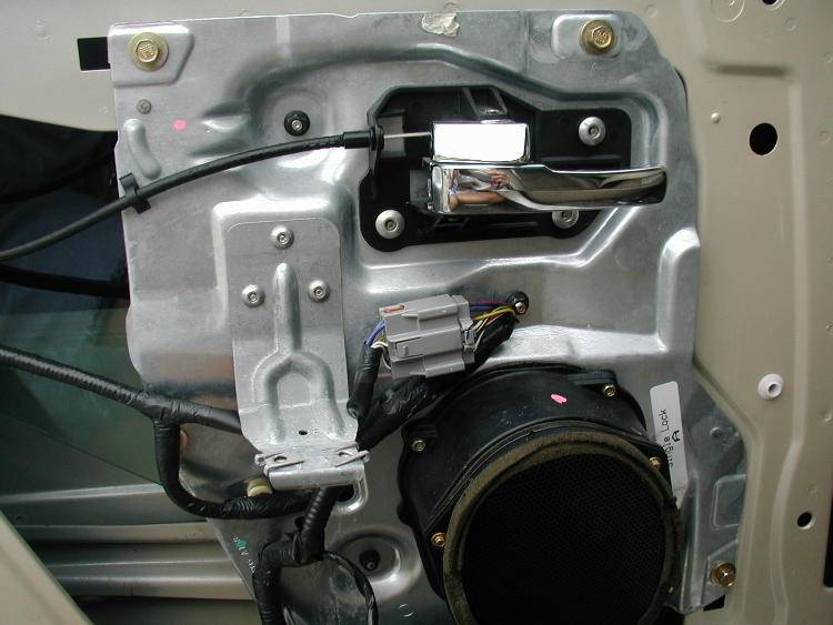

Remove the cover, just peels off and sticks back on.
Remove the 3 black nuts that hold the window motor to the door. I would have circled them but I'm not able to.
Remove the 4 gold bolts that hold the inner door frame to the door. You can now separate the door frame from the window motor/window and lower it into the door.

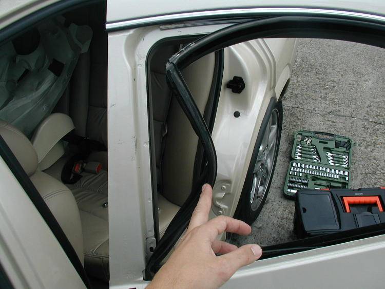

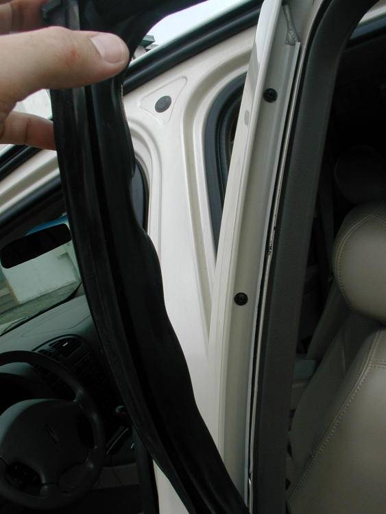

Pull the weather stripping from the window channel, just enough to get a phillips screw driver in a remove the 3 screws.
Reverse the proses to put it back together.

The windows don't roll all the way down. I had to take the door panel off to take apart the inner door which allows the window to drop down into the door.
I took pictures when I was putting it back together.
