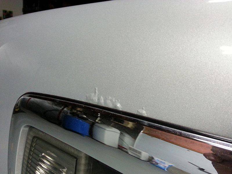

Several months ago I noticed paint blistering around the trunk license surround. The blistering is such that there is, quite obviously, corrosion of the aluminum panel. I know that this was addressed long ago, but I didn't have the problem then. Cam someone direct me to the information as to how to go about dealing with this. I don't want to fix it and then have it come back.

I thought there was some kind of contamination during the painting process. it needs to be fully refinished with the aluminum being properly prepped.
Yep, iron particles. Trunk lid, hood and both front fenders are affected on my LS.

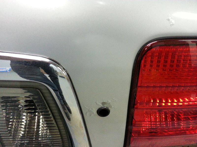

BigRig - thanks for the info - very interesting. I too have some minor bubbling around the license plate surround and although it's hardly noticeable, it's always annoyed me.
I think this was an issue for multiple years. My 2000 LS has this on several locations on the trunk lid, and has for 6-8 years. I wish to have it repainted and repaired as well, some day. My 2006 LS never had this problem however.

Since Aluminum has a habit of oxidizing rather than rusting, it's the nature of the beast. Galvanic corrosion makes things worse ie: Hyundai Pony

Sand blasting and it's going to need a treatment before primer/paint get's laid back over top.
My '03 LS has it around the trunk surround, and my '05 CTS has it at the grill. Seems like in my cases it starts out as mechanical abrasion breaking through the paint and then a chemical process taking over.
Gus, I agree. Since I started this thread, I've noticed that it's also showing-up alongside of the scuff-plates that surround the hood locking pins I installed.
