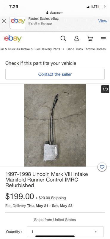

This would be the controller to it correct ? This what makes it open up ?
