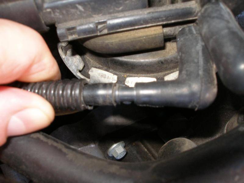

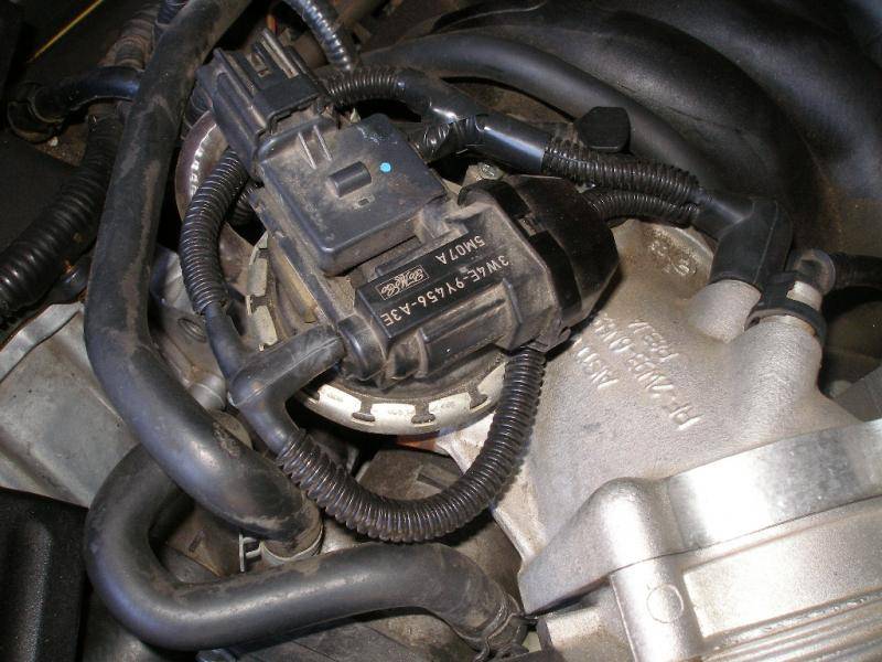

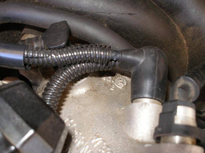

First off check for a vacuum leak. The plastic had lines get brittle and crack. I leaned on the vacuum harness and cracked a couple of these lines inside the plastic loom and had to follow the lines to find the failure. Here is my repair....
