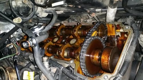

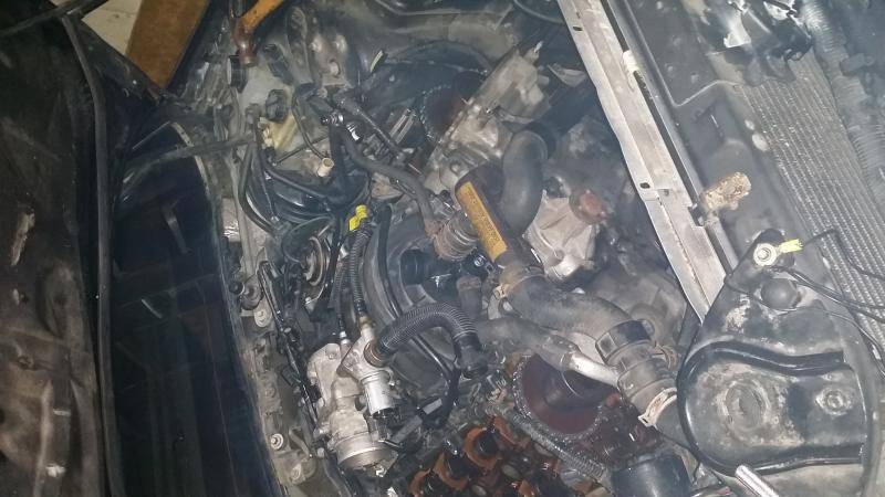

I checked the alternator and battery all was good. I also followed the guide and checked the CPS, all was good. I took the valve covers off and the driver side was slanted a little off in comparison to the passenger side.
After cursing myself out for a few minutes I took everything back off again and readjusted the driver side cams without touching the passenger side which sits in front. No tool needed just a handy friend to crank the cam into place as I sat the chain, guide and tensioner in. Got it up and running a few hours ago and no CPS light, so far.
I took a photo and you an barely tell its a little off but it was...somehow I managed to screw it up before. Its up and running great again as never before ;/ Putting new ball joints, brakes/rotors and windshield in this week. Ready for the next repair it throws at me, another LS8 saved for now. Thank you all for the information provided :cool: The sad thing is I've torn this thing down so many times that if I run across a new LS8 for a decent price I'd buy it.....stupid me.
