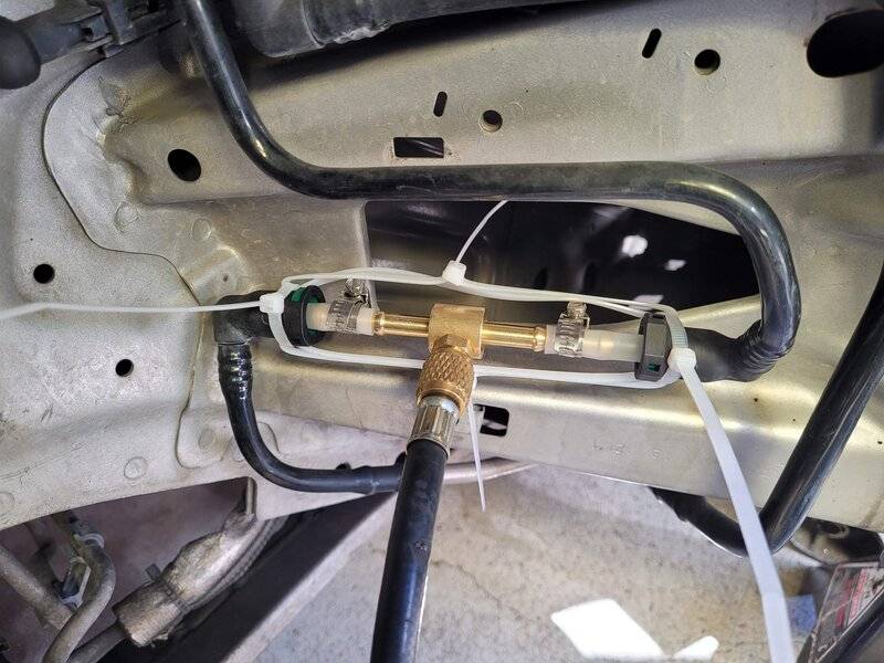

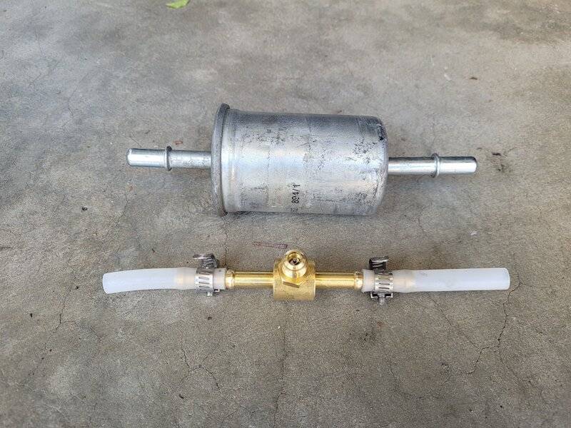

Update. The code hasn't come back but my long term fuel trims are still -14 and -18 ish. Sometimes I think both banks are the same and sometimes I think bank 2 is 4% worse. On my second tank of gas with Seafoam and haven't seen a change. Just replaced the fuel filter today and checked the fuel pressure while I had it apart. I have attached some photos for anyone who is interested. It still infuriates me that there is no Schrader valve. Fuel pressure was about 5 lbs less than the pressure Forscan is showing. I think that rules out the fps. Next step is pulling plugs I guess. I would expect the banks to be a lot different if I had a leaking injector. I suppose I could have more than one.
The piece is from a fuel pressure tester kit that I loaned from Oreilly's. The plastic hose is 3/8 od and is rigid enough to withstand vacuum which is why I bought it in the first place. I put some zip ties on in case the pressure wanted to push out the lines.
