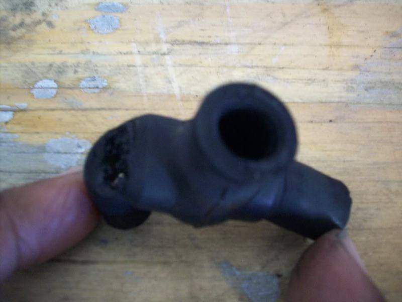

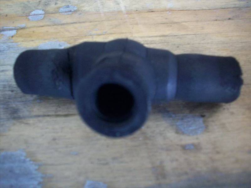

You have a vacuum leak. That is first and foremost that you must check first. Check your air tube for cracks, make sure there's no leak there, Check your PCV valve, go ahead and replace it, they are too cheap. The PCV runs to a rubber T then Y's off to the intake manifold. Check that T and make sure it dont like mine.
